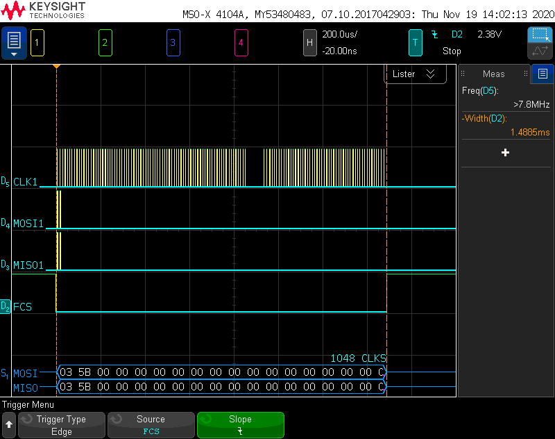

  • Hi Garrett,
    thanks for good hint.
    I have made this hack in run time to reach MCSPI1 from R5F:
        /* add MCSPI1 to driver table */
        SPI_socGetInitCfg(2, &spi_cfg);
        spi_cfg.baseAddr = CSL_MCSPI1_CFG_BASE;
        SPI_socSetInitCfg(3, &spi_cfg);
        /* configure MCSPI1_CLK pin mux for reception, hack of pdk */
        HW_WR_REG32((CSL_CTRL_MMR0_CFG0_BASE + CSL_MAIN_CTRL_MMR_CFG0_PADCONFIG0 + MCU_SPI1_CLK_PADCFG_OFFSET), PIN_MODE(0) | \
                    ((PIN_PULL_DISABLE | PIN_INPUT_ENABLE) & (~PIN_PULL_DIRECTION)));
    Then I will try to add more details to the "hacked" entry according to your advice.
    Any very simple code example is welcome: I would like just to send and receive a buch of bytes at first and watch the signals by scope. I have  looped back MOSI to MISO pins of J20 connector by a jumper cap.
    Kalman

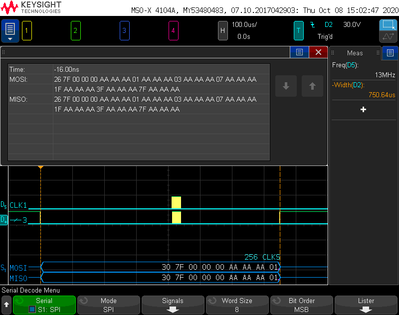

    See my oscillogram:
    Chip select is low for ~750 usec, the data transfer (32 bytes @ 12.5 MHz) takes abut 26 usec. That is why I do not close this topic here.
    How could I avoid wasting such long time?
    Kalman

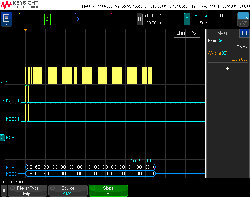

    I have made some performace evaluation: transfer of 131 bytes (reading 128 bytes from a 64kB EEPROM) @ 10 MHz SPI clock frequency, FIFO off
    Clean data transfer time is 131 * 0.8 usec = 104.8 usec
    1. PDK
    Width of ChipSelect is 5.6 msec, divided by 131 = ~42 usec / byte
    2. McSPI
    I have written my own spi transfer function using mcspi.
    Result: 1.488 msec / 131 bytes = ~ 11 usec / byte
    3. Avoid repeated address calculation
    I have improved my code to avoid register address calculation made by each mcspi function call. I have defined pointers for involved registers; calculated pointer values just once at enetering my transfer function and accessed the registers by pointers.
     uint32_t* rxReg = (uint32_t*)(baseAddress + CSL_MCSPI_RX0 + (chNum * 0x14));
    newData = *rxReg; // instead of HW_RD_REG32(baseAddr + MCSPI_CHRX(chNum))
     Result: 327 usec / 131 bytes = ~2.5 usec / bytes
    I will try to add FIFO handling to my code expecting even better result,
    Is there any plan to improve the performance of the driver?
    And I need your help again: is there an interrupt driven SPI exampe available?
    I have tried to enable interrupt in the SPI_HWAttrs structure but the code run to abort. It could be my fault, but I do not know how to make it better?
    Kalman

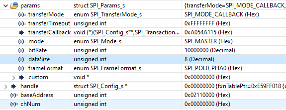

  • Hi Dillon,
    I have changed to SPI_MODE_CALLBACK, but got the same result. And added a callback function, which was never called (because the interrupt handler runs just once instead of 5 times...)
    Here are my parameters before calling SPI_open ( they are OK, I get what I expect)
    Then I do Master mode read/write by calling SPI_transfer function.

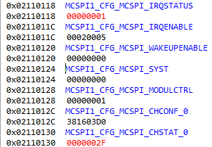

    I think there is something wrong in the MCSPI_v1_hwiFxn interrupt handler.
    It reads the interrupt status register at the beginning and saves it in intCode. Then reads/writes the Tx/Rx registers, changes the FIFO trigger levels when necessary, etc AND finally clears the interrupt according to saved intCode. When the same interrupt rises during the operations then it will be lost.
    And YES, this happened!
    IRQSTATUS was 0x00000001, CHSTATUS was 0x0000002A at beginning of MCSPI_v1_hwiFxn interrupt handler. I cleared the IRQSTATUS by hand, and got this at the end:
    CHSTAT has changed to 0x2F, IRQSTATUS has changed back to 1 during sending/receiving 32 bytes. This 1 will be cleared by the last instruction and the interrupt will be lost.
    Could you check this, please?
    Kalman
  • Hi Dillon,
    moving the IRQ clear to begin of interrupt handler form end helped, but not enough. I have changed an rebuilt the PDK (in 2-3 hours :-) ) and got this:
    Interrupt has run 4 times (instead of 1!!!), XFERLEVEL = 0x00030302, 3 bytes are remaining, FIFO trigger levels are adjusted properly; CHSTAT = 0x2F, but IRQSTATUS is 0. Then 5th interrupt call is missing which should send the remaining 3 bytes and read 4 and close chip select, i.e finish the operation.
    Do you have any idea?
    Kalman
  • Hi Kalman,
    Try setting a breakpoint within MCSPI_v1_hwiFxn and stepping through your code to see the exact moment that IRQSTATUS is set to 0. And once you track down the condition that's setting IRQSTATUS to 0 early, post it here so I can better understand what might be causing the issue that you're facing.
    Dillon
  • Hi Dillon,
    here is my summary:
    Irq
    No
    Src
    Line
      IRQ
    ENABLE
    IRQ
    STATUS
    CH
    STAT
    XFER
    LEVEL
    CHCONF Remark RxFFF RxFFE TxFFF TxFFE EOT TxS RxS
    3 944 before McSPIIntStatusClear 00020005 1 2F 00431B1F 381603D0   0 1 0 1 1 1 1
      946 after McSPIIntStatusClear   0 2F 00431B1F     0 1 0 1 1 1 1
      961 after MCSPI_transmitData_v1   0 0F 00421B1F   w1 0 0 0 1 1 1 1
      985 after MCSPI_receiveData_v1   0 2F 00421B1F   r1 0 1 0 1 1 1 1
      961 after MCSPI_transmitData_v1   0 0F 00241B1F   31 bytes were transmitted 0 0 0 1 1 1 1
      985 after MCSPI_receiveData_v1   0 2F 00241B1F    r31 0 1 0 1 1 1 1
      961 after MCSPI_transmitData_v1   1 0F 00231B1F   w32 0 0 0 1 1 1 1
      985 after MCSPI_receiveData_v1   1 2F 00231B1F   r32 0 1 0 1 1 1 1
    4 944 before McSPIIntStatusClear   1 2F 00231B1F     0 1 0 1 1 1 1
      946 after McSPIIntStatusClear   0 2F 00231B1F     0 1 0 1 1 1 1
      961 after MCSPI_transmitData_v1   0 0F 00041B1F   31 bytes were transmitted 0 0 0 1 1 1 1
      985 after MCSPI_receiveData_v1   0 2F 00041B1F   r32 0 1 0 1 1 1 1
      961 after MCSPI_transmitData_v1   0 0F 00031B1F   w32 0 0 0 1 1 1 1
      985 after MCSPI_receiveData_v1   0 2F 00031B1F   r32 0 1 0 1 1 1 1
      1057 after McSPIFIFOTrigLvlSet   0 2F 00030302   prepare last IRQ 0 1 0 1 1 1 1
    First and second run equals to third. CHSTAT.RXFFE flag toggles at writing/reading each byte. IRQSTATUS.TX0_EMPTY is set after writing the 32nd byte, except for the 4th run.

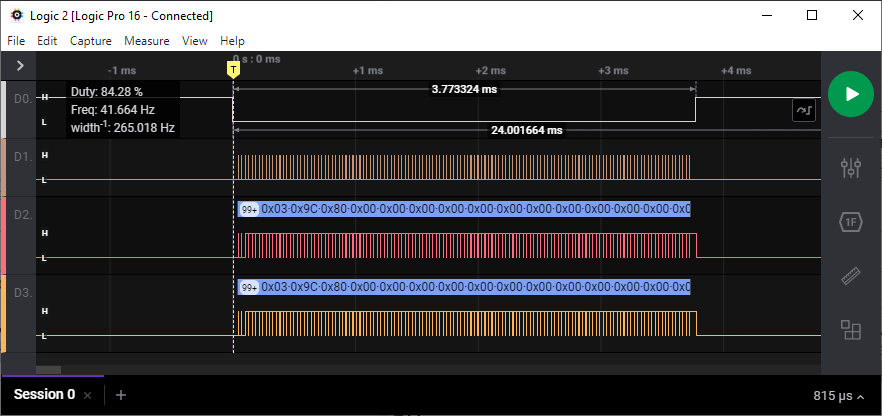

    This is the interrupt driven SPI transfer with the modified interrupt handler (FIFO off)
    3.77 msec transfer time is better than 5.6 msec with polling but too slow (131 bytes @ 10 MHz, ~ 28 usec/byte).
    Do you have a better SPI driver?

  • Hi Dillon,
    the problem (missing last interrupt) arises when more transfers are required and the last chunk is less than the FIFO size.
    ByteCount SPI bytes Result XFERLEVEL IRQEN CHSTAT
    10 10 OK 00000909 00000000 2E
    64 64 OK 00001B1F 00000000 2E
    65 64 BAD 00000001 00020005 2F
    95 64 BAD 001F1B1E 00020005 2F
    10 & 64  bytes were OK, transfer finished properly, CS went high, driver turned off the SPI channel.
    65 & 95 bytes were bad, 64 bytes were sent, last interrupt was missing, CS stayed low.
    Do not ask me to test all possible FIFO length settings, I would left that duty for sw fellows of TI ;-).
    But it would be interesting to discuss the problem with hw developers: what happens here and why is the expected interrupt missing?
    Kalman

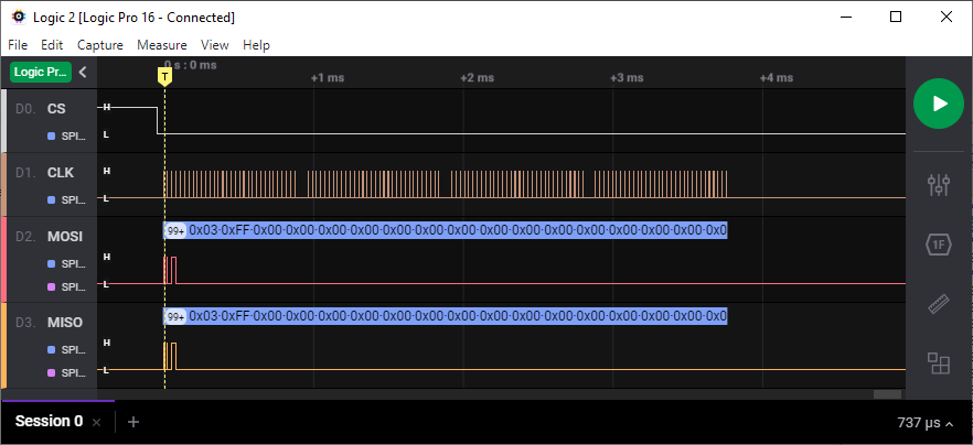

    Here is my polling code which produced the shortest execution time, ~210 usec for 131 bytes @10 MHz (till now):
    bool Spi::txrxRegP1OL(uint8_t* spiTxData, uint8_t* spiRxData,
                        size_t spiDataLength) const // overlapped transmission
        volatile uint32_t  readData;
        volatile uint32_t* chRegs
            = (uint32_t*)(baseAddress + CSL_MCSPI_CH0CONF + (chNum * (CSL_MCSPI_CH1CONF –
     CSL_MCSPI_CH0CONF))); // chNum * 0x14
    #define chconfReg (chRegs)
    #define statusReg (chRegs + ((CSL_MCSPI_CH0STAT - CSL_MCSPI_CH0CONF) >> 2)) // 1
    #define chctrlReg (chRegs + ((CSL_MCSPI_CH0CTRL - CSL_MCSPI_CH0CONF) >> 2)) // 2
    #define txReg     (chRegs + ((CSL_MCSPI_TX0 - CSL_MCSPI_CH0CONF) >> 2))     // 3
    #define rxReg     (chRegs + ((CSL_MCSPI_RX0 - CSL_MCSPI_CH0CONF) >> 2))     // 4
        // no fifo
        McSPITxFIFOConfig(baseAddress, MCSPI_TX_FIFO_DISABLE, chNum);
        McSPIRxFIFOConfig(baseAddress, MCSPI_RX_FIFO_DISABLE, chNum);
        *chctrlReg = *chctrlReg | MCSPI_CH0CTRL_EN_ACT;     // enable channel
        *chconfReg = *chconfReg | MCSPI_CH0CONF_FORCE_MASK; // CS on
        *txReg = spiTxData ? *spiTxData++ : 0;  // send 1st
        spiDataLength--;
        while ( !(*statusReg & MCSPI_CH_STAT_TXS_EMPTY) );
        while (spiDataLength)
            *txReg = spiTxData ? *spiTxData++ : 0;  // send next
            while (MCSPI_CH_STAT_RXS_FULL != (*statusReg & MCSPI_CH_STAT_RXS_FULL));
            readData = *rxReg;  // get previous
            if (spiRxData) {
                *spiRxData++ = readData;
            spiDataLength--;
        readData = *rxReg;  // get last
        if (spiRxData) {
        *chconfReg = *chconfReg & ~MCSPI_CH0CONF_FORCE_MASK;    // CS off
        *chctrlReg = *chctrlReg & ~MCSPI_CH0CTRL_EN_ACT;        // disable channel
        return true;
    There is no time-out check (would be advisory), deals with NULL pointers properly (but could play RXonly/TXonly modes of SPI port instead), FIFO configuration could be made once in initialization (but I was experimenting with several different configurations parallel).
