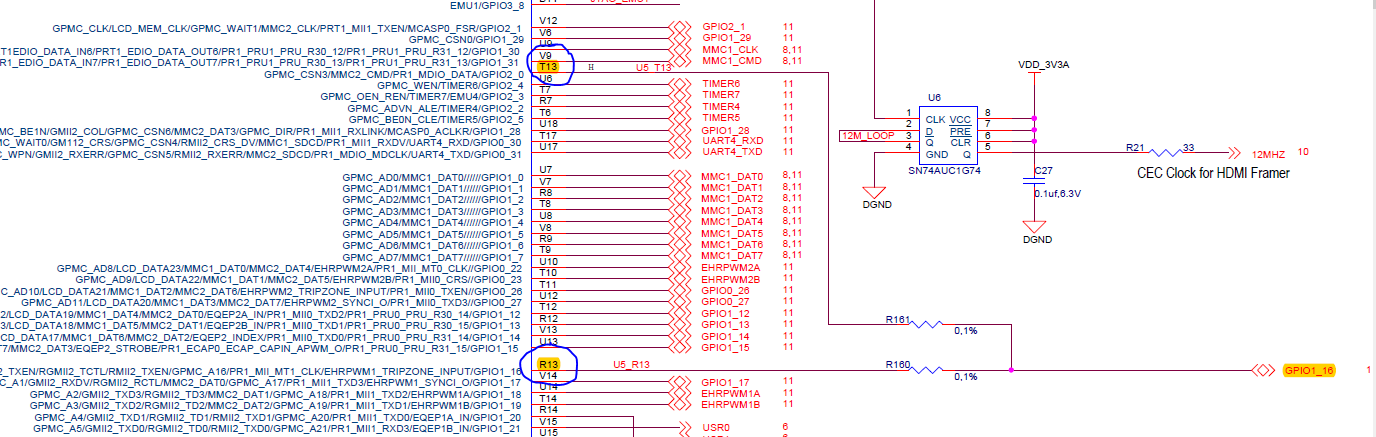

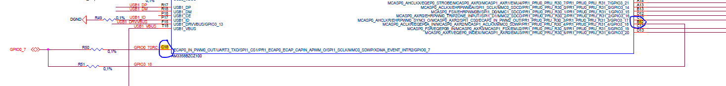

With reference to the BeagleBone Schematic, we see that some of the GPIOs are connected to each other through 0 ohm resistors before coming to the expansion headers.
What is the intention behind this?

Hi Venugopal,
Unfortunately the image you attached is not viewable. Can you be more specific on the GPIOs to which you are referring?
Regards, Bill
Hi Venugopal,
Normally this type of arrangement would be used to allow either one or the other of the SoC pins to be connected to the expansion connector. On the beaglebone both resistors are installed which is puzzling. Unfortunately the Beaglebone is not a TI product and was not designed by TI. You will have to post this question on the Beaglebone forum.
