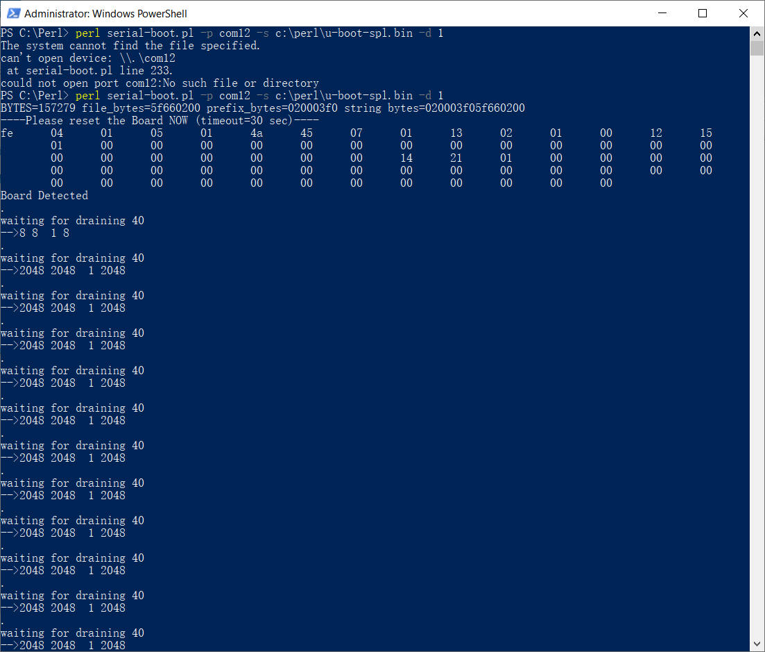

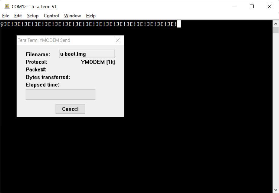

    First question: We have done he boot up test in 2 option:
    1.UART:
    The issue is that when the device is boot up, we will continuously receive a message" JEJEJEJE..." from the HyperTerminal. And we get no response when we trying to download the SPL.
    Do you have any relevant material that is available for us in order for us to boot from UART?

    and we follow the SOP, power up the board to download the SPL. serial port setting at 115200, 8,EVEN,1, no flow control.
    Until complete.
    Then try to download U-Boot.im from Teraterm using Y modem, (tried with Settings 115200,8 EVEN,1 and 115200,8,N,1). both unsuccessful.
    Could you pls help to solve the issue?
  • ZaiHang,
    A few more setup questions:
    1. Are there only one COM port you can connect to?  I am expecting to see "CCCC" as according to the PDF and not "JE!JE!JE!JE!" like in your setup.  Looks like the serial connection was not configured correctly

    1. Are there only one COM port you can connect to?  I am expecting to see "CCCC" as according to the PDF and not "JE!JE!JE!JE!" like in your setup.  Looks like the serial connection was not configured correctly.
    The comport is connected through an on-board FT2232HL to USB, together with the JTAG port, exactly follow the design in AM571x EVM.
    I believe it is correct the UART3 shall sent "JE!JE!..." continuously when the board is powered up.
    However, it is wrong when we download U-Boot-SPL.bin into the board through UART3. The correct response shall be "CCC..." when did the same on the EVM IDK. SO what could possibly be wrong? because we saw the SPL downloading is successful from PERL terminal. Shall the SPL code be modified for custom board?
    1) Can you confirm that on the TI IDK you are able to get UART boot functional? Can you get to u-boot prompt with UART boot on TI IDK?
    2) Do you have pins same as TI board on your custom board for UART3 pins? Can you confirm that as well?
    Keerthy
    Below is the reply:
    Yes, the IDK response "CCC..." and works well.
    IS it possible that we need to modify the SPL file for our design since the QSPI is removed from the EVM design?
    Yes, confirm.
