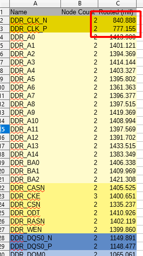

I used the EMIF tool to prepare and verify (GEL script) the SDRAM.
I did a memory test using GEL script from EMIF tool. There were no errors detected.
Can I ask for a review of my EMIF spreadsheet:
2086.W631GU6MB_EMIF_Configuration.xlsx
Is it anything suspicious in it?
What can I do to find the source of this issue?
How can I investigate if it is the SDRAM issue?
How can I confirm that it relates to the SDRAM issue?
What are the recommended steps to troubleshoot this issue?

  • Hi Adam,
    Did you use the u-boot tab to update your u-boot files?  Can you attach your board.c file for review?
    Please download the following JTAG script:
    http://git.ti.com/sitara-dss-files/am335x-dss-files/blobs/raw/master/am335x-ddr-analysis.dss
    Directions on how to run it can be found here:
    http://git.ti.com/sitara-dss-files/am335x-dss-files/blobs/master/README
    Brad

  • Hi Brad,
    I think I've found the issue.
    The CLK_N and CLK_P traces were left unmatched to the rest of the address net class.
    The guy who did the PCB design has to correct this.
    See below.
    Could this be the source of the problem in your opinion?
    As usual, your expertise was incredibly helpful.
    Thank you.
    Adam
  • I don't know if it is THE issue, but it's definitely an issue...  CLK_N/P should be within 5 mils of one another.  Also an issue is the fact that these clock signals are significantly shorter than the other address/control signals.  The longest and shortest address/control/clock signals should be within 100 mils of one another.
    Are you able to upload the full spreadsheet of trace lengths?  Given the significant issues I've seen so far, there may very well be more.
  • Take a look: DDR_traces.xlsx
    Every clock is matched separately and not within the class it belongs to. For sure, it must be corrected.
  • Agreed.  The DQS_N/P signals need to be within 5 mils of one another (which they are).  However, those signals should be within 25 mils of the other signals in that same byte lane.  Furthermore all of the data signals should be within 25 mils of each other.  At this point, I would agree with your earlier statement that you will need to revise the board.
