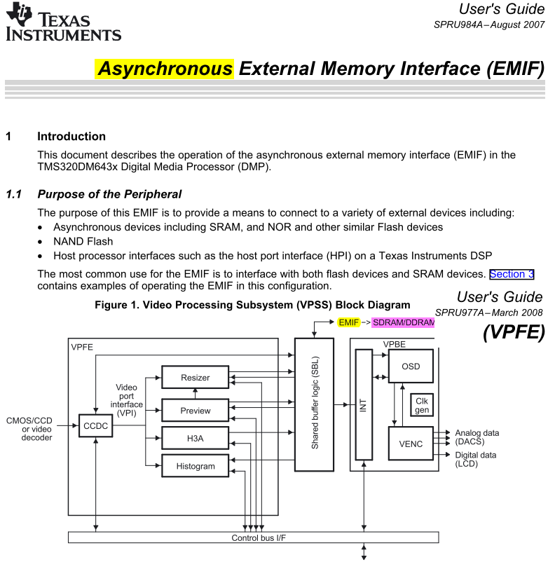

I would like to ask some questions on EMIF.
SPRU984a has its full name to be Asynchronous External Memory Interface, but VPFE document says CCDC should be connected via EMIF to SDRAM.
So is SDRAM (of which DDR2 is a special type), whose full name is Synchronous dynamic Random Access Memory, an asynchronous or synchronous device? Isn’t there any inconsistency here?
Zheng
  • I believe the term EMIF is in a generic sense, as in External Memory Interface, of which the DDR2/SDRAM Memory controller is one.  This is what is being suggested, not the Asynchronous EMIF.

    So "asynchronous" in its title in SPRU984a, in this regard, is an improper prefix?
    Zheng
    No, it is absolutely proper.
    The TMS320DM6437 has 2 physically separate and independent external memory interfaces, a DRAM interface as described in SPRU986 and the asynchronous memory interface as described in SPRU984.
