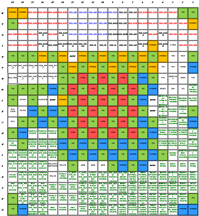

I used Excel’s conditional formatting to highlight pins according to their types and obtained a colored pin map (top view) like below:
All those cells in solid color are supply or ground pins:
1.      VSS = green
2.      DVDDR2 = orange
3.      DVDD33 = blue
4.      CVDD = red
And all those underlined are DDR2 related pins. Are those with bold font in deep green are pins that are multiplexed with GPIO.

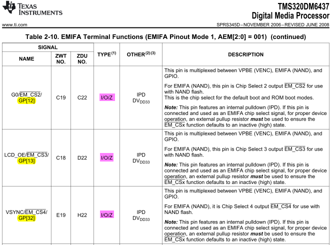

On the other hand, I have found that most of GPIO multiplexed pins have either IPD or IPU. If they already have pulling resistors, does this mean I can also safely
1.      Set them as INPUT
2.      And
                                i.            Connect to DVDD33 if it has IPU
                              ii.            Connect to VSS if it has IPD
Logically, all the above solutions (either as OUTPUT or INPUT and making their associated connections) seem would work. But practically, which is better? What is TI’s recommendation?
My last question is on IPU and IPD resistors. Since pins with such description are described as having the ability to internally turn on a puling resistor, then how large resistance (in Ohm) does these resistors offer? Since they are situated within the silicon ship, then it seems unlikely that they can be made using material of common external ZWT or through-hole resistors, so what are they made of? Someone told me that they are something like “MOS resistor”, is it true?
And for GPIO pins with IPD or IPU, do I still need to connect an external pulling resistor when they are used as input pins?

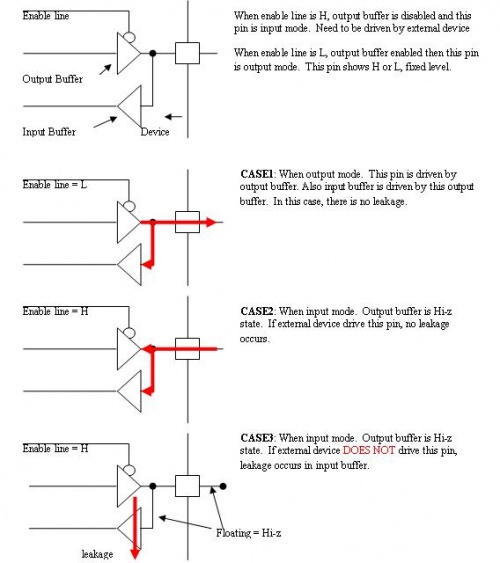

    For 2), Miguel classified three mutually exclusive cases. But what about for GPIO pins? In order to ensure it falls in one particular case, does the user need to first programmatically set whether it is INPUT or OUTPUT? And during booting time such that the code has not yet run, what is the default state of GPIO pins? Will there be a problem?

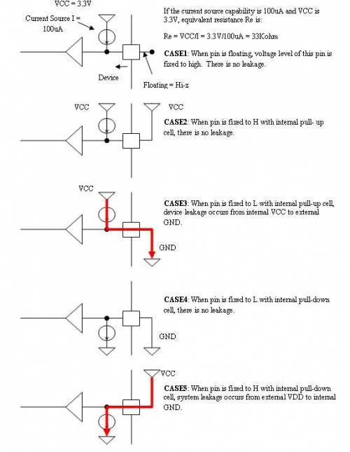

    And from http://processors.wiki.ti.com/index.php/Optimizing_IO_Power_Consumption,
     Is this a good advice?
    Another question is that I don't quite understand the current source and the leakage mechanism in Fig 3 there. Is the current source of the transistor type? Why does the leakage in the 3rd and 5th case?
