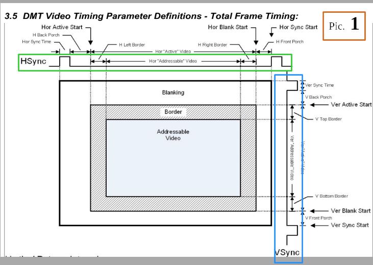

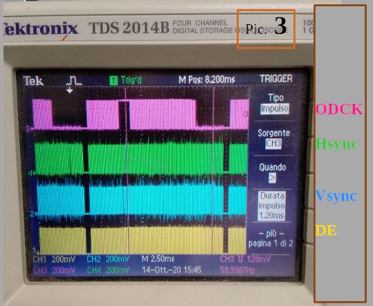

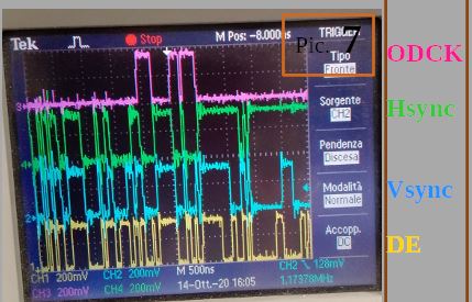

PROBLEMS and QUESTIONS:
1) why do the TFP401 Vsync Hsync pins give me unstable signals?
2) according to datasheet on page 15 "Table 2. TFP401 / 401A Modes of Operation" ODCK should work in "falling"
but pin switching (Hsync, Vsync, DE) also occurs without ODCK variations
3) according to datasheet on page 13 "Table 1. TMDS Pixel Data and Control Signal Encoding" DE (on ODCK front) can be used for
to discriminate valid RGB data from Hsync Vsync signals?
4) can you help me understand where where by misinterpreting the datasheet)
