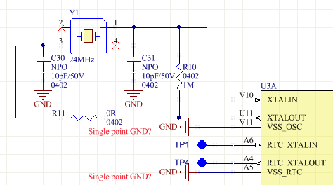

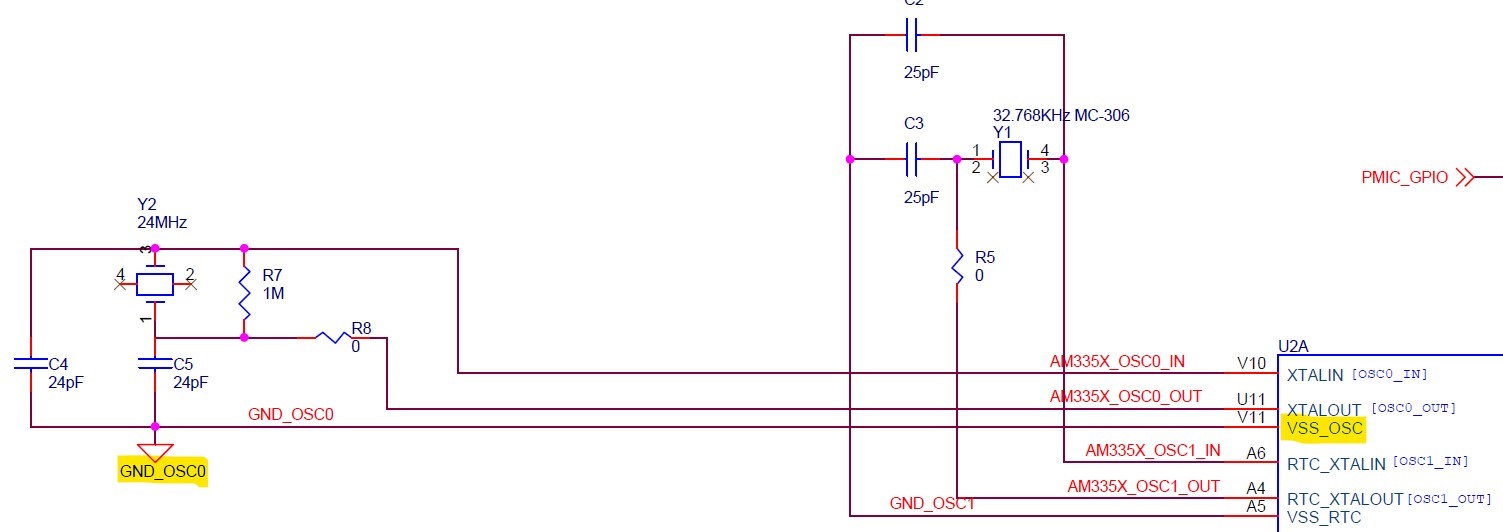

I check the am335x_gpevm sch,
May I design the VSS_OSC GND as below?single point GND?
Could you give some suggestions about the VSS_OSC GND layout?
Daniel

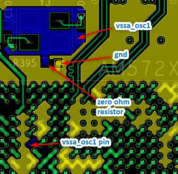

In more recent designs we have moved away from the isolated VSS_OSC connection. The schematic you included accurately represents what we have implemented on the AM574x GP EVM but we included a zero ohm resistor between GND_OSC0 (shown as vssa_osc1 in the image below) and the ground plane for the board. The VSS_OSC pin is connected with an internal trace to the small plane under the crystal. The resistor acts as a single point of contact between the ground for the crystal circuit and the board ground.
Regards, Bill
