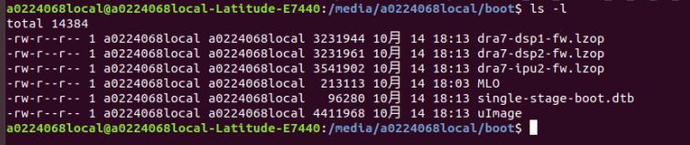

    step 6. format SD card and prepare it.
    sudo./hlos/scripts/linux/mksdboot.sh --device /dev/sdc --appname apps --makeconfig tda2xx_evm_linux_all
    step 7. disconnect SD card and re-insert it to PC. run early-boot-update.sh to apply early-boot.
    ./hlos/scripts/linux/early-boot-update.sh tda2xx_evm_linux_all /home/a0224068local/1Twork2/vision/PROCESSOR_SDK_VISION_03_08_00_00/ti_components/os_tools/linux/targetfs /media/a0224068local/boot
    step 8. disconnect SD card and insert to TI J6 EVM. run it.
    the boot partition of the SD card shown in below picture. attached the content for your check.7762.boot.zip

  • Dear Gaviraju.
    seems the capture picture of boot partition lost in last reply. attached it again for your check.
    Thanks a lot!
    yong
    Can you try with the below binaries & let me know the status.
    8611.Boot.zip
    Gaviraju

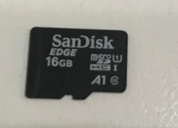

    I'm able to run with those binaries.
    Trying to boot from MMC1
    Loading Environment from MMC... OK
    spl_load_image_fat_buf: error reading image u-boot.img, err - -2
    spl_load_image_ext_buf: ext4fs mount err - 0
    which seems to be something wrong with the SD card. I will check with an MMC expert & let you know.

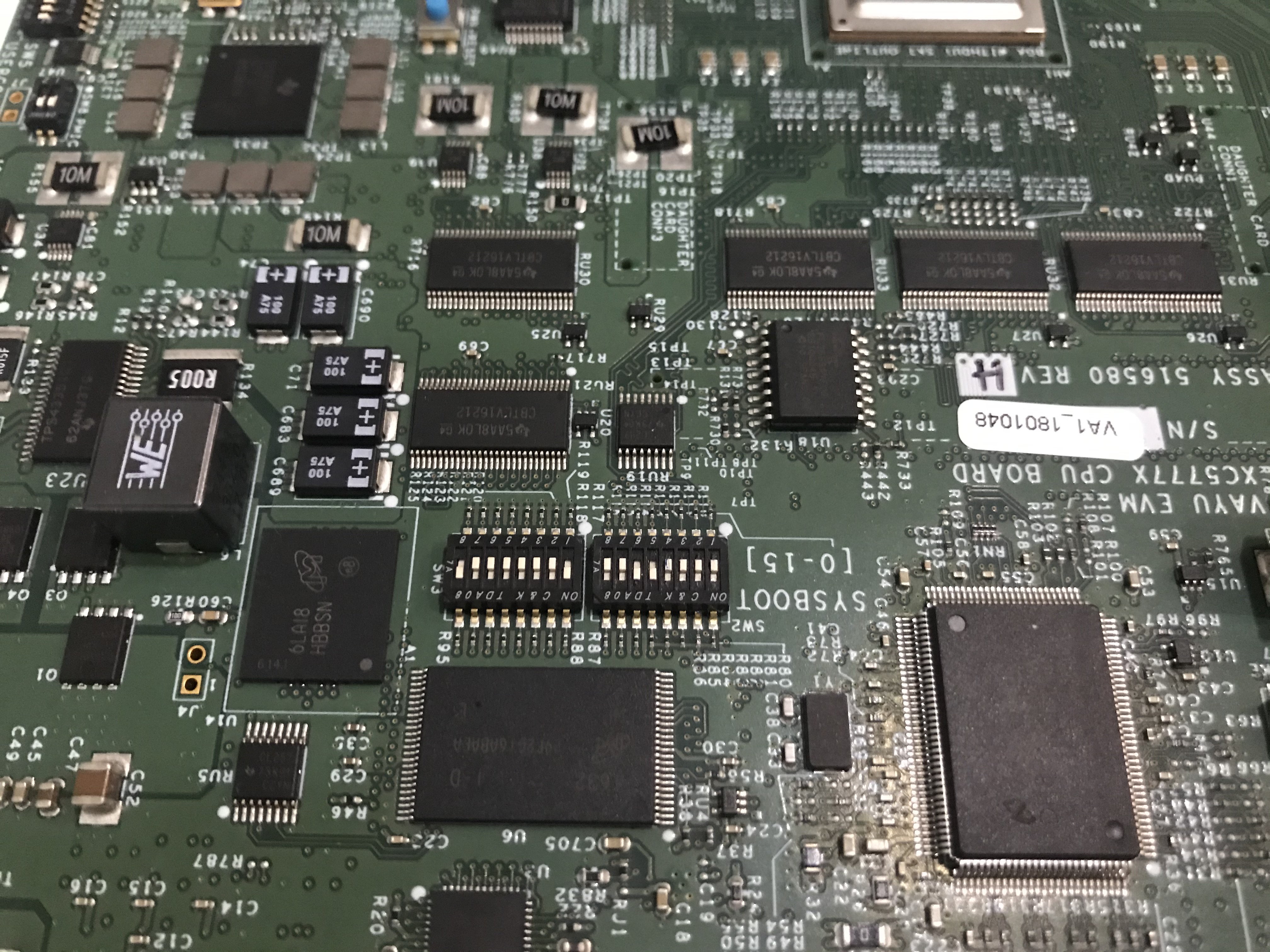

    BTW,
    here is SYSBOOT[0-15] and USERCONFIG switch state.
    Thanks a lot!
    yong
    Refer to the below thread for the SWITCH boot mode settings for SD boot
    Gaviraju
  • Dear Gaviraju.
    thanks for your help! I follow the ticket, and set SW5 to 0001100000, it works now.
    I will close this ticket.
    thank you!
