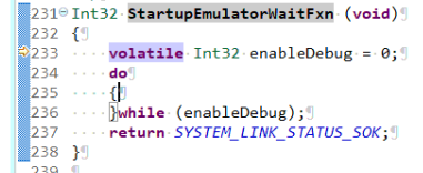

    Please build the A15 application (apps.out) in debug mode & run the same application with the GDB to find out where exactly it's blocking

    Sorry, the path /sys/kernel/debug/remoteproc will not exist for the early boot late attach use-case, so follow the below procedure to debug further.
    File: vision_sdk/links_fw/src/rtos/bios_app_common/tda2xx/dsp1/src/main_common_c6xdsp1.c
    By default, the variable enableDebug = 0 in the function "StartupEmulatorWaitFxn", so set this variable to 1
    volatile Int32 enableDebug = 1;
    After making the above changes rebuild the code, prepare SD card again & run the demo again (Now in this scenario the DSP is blocking in the main function because we set the variable enableDebug = 1)
    Now connect the JTAG debugger to the target board then launch the script & connect the DSP core, load the symbols then start debugging the code & find out where it's hung-up or crashing.
    Note: We should remove Gel files before connecting to any core for the SD & QSPI boot mode, for more information about removing gel file, please follow the below thread
    Gaviraju
    I use JTAG and CCS connect to DSP, but it can't connect to DSP.
    The log: C66xx_DSP1: Error connecting to the target: (Error -1180 @ 0x0) Device is held in reset. Take the device out of reset, and retry the operation. (Emulation package 7.0.48.0)
    Then I find the config in uboot is lack of CONFIG_LATE_ATTACH.
    It seems that TDA2 RVP is not config to support early boot late attach,
    so I compare to tda2 evm config and modify d3_tda2x_defconfig in uboot.
    After double check uboot and kernel config, I rebuild it and boot from SD.
    The issue occur at last post is solved.
