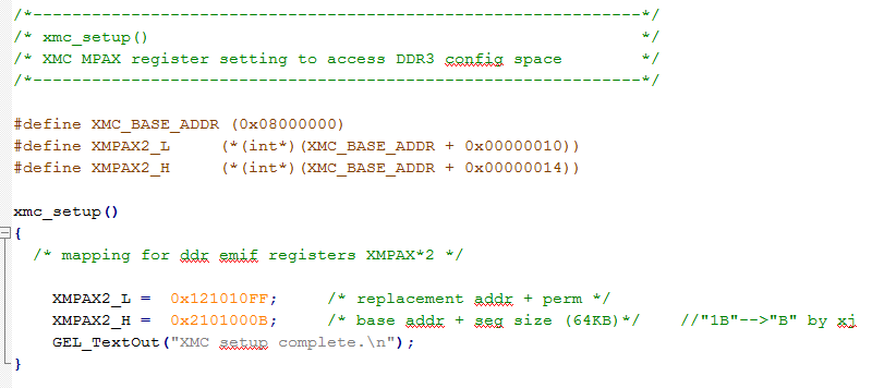

    • How big is your DDR3A memory? In case it is bigger than 2GB, do you use MPAX to map the 36-bit physical address to logical address?

    2) XMC is initialized as per the GEL file :
    3) external DDR3A is 4GB
    4) when in the stuck waiting state, it is still possible to halt the process, execute step-by-step disassembly (actually pooling the IPR register), watch internal register, and so. But as soon as we try to open a DDR3 memory view window, CCS access to that core0 fails. Yes we loose JTAG access to the K2H. It is the same if we manually change the Bxx internal register so that to end the waiting loop and go back to the main() pgm (stll in step-by-step disassembly) : CCS loose access to CORE0 upon the first encountered CPU access to external DDR3.
