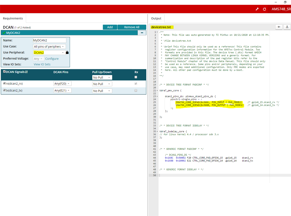

Hello support!

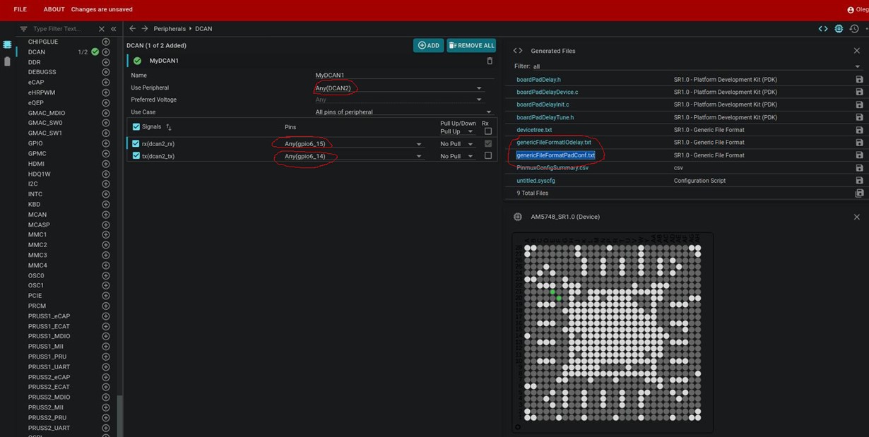

I would like to know how to use pinmux tool.
I mean I wold like to add dcan2 for example.
1.You still didn't get am5749
2.I chose what I want for example:
3.Like I understood I should use some script for generating code from this files(genericFileFormatPadConf.txt and genericFileFormatPadConf.txt). I should get some file and integrate this code in mux_data.h
it is will be something for: const struct pad_conf_entry core_padconf_array_essential_am574x_idk and for const struct iodelay_cfg_entry iodelay_cfg_array_am574x_idk.
4.In devicetree.txt I will get code for Device tree obvious.
So which scrip I should use where I should get it?
I will try to download something but it doesn't generate code for 2 files.

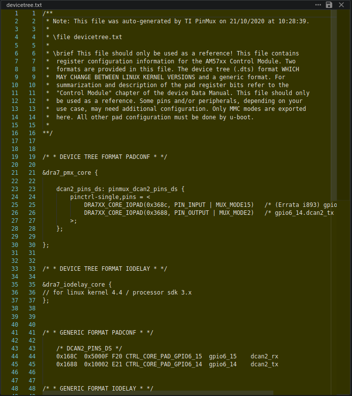

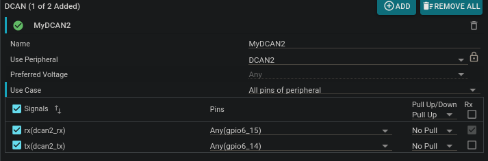

  • Karan, You are great specialist  but I need more detail explanation.
    So...I chose Dcan2
    then look at the pins...
    we see MODE IS 16 FOR DCAN2
    Ok no problem look at the devicetree.txt
    The mux mode here it is 15 and 2....So I have a reasonable question what is wrong and how it is possible....
    Listen to me, I just want to understand how to use this tool correctly.
    I am completely sure that due to a misunderstanding of the principle of operation, I have problems with the periphery.

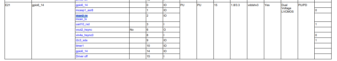

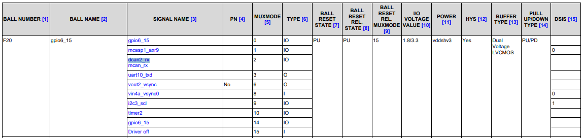

  • Hi Oleg,
    I believe this is a bug in the pinmux tool - I have raised it up with the concerning team. I see values > 15 which is not possible. I will give you a confirmation when I hear back from them.
    To get the correct MUX MODE you can look at the datasheet - https://www.ti.com/lit/gpn/am5749
    So for the dcan2_tx signal:
    In the pinmux tools output you can see it says gpio6_14.dcan2_tx. This means that the BALL NAME is gpio6_14 and it is muxed for dcan2_tx.
    The gpio6_14 corresponds to BALL NUMBER E21 and the MUX MODE for dcan2_tx is MUX MODE 2.
    So for the dcan2_rx signal:
    For dcan2_rx if you look at the datasheet you will see the below. It is MUXed at MUX MODE 2 for BALL gpio6_15 (F20). So it should have been MUX MODE 2 for this but the pinmux tool says errata i893.

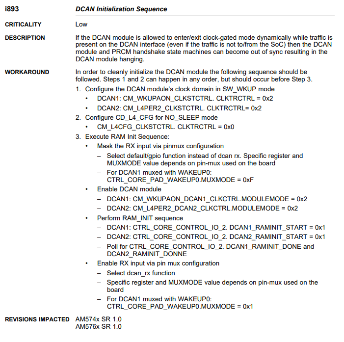

    If you look this up in the errata document at https://www.ti.com/lit/pdf/sprz447 you will see:
    So the deviation from the data sheet on the MUX MODE is due to this errata.

  • Hi Karan,
    Karan I am newcomer and I thought it would be easy to do through pin mux tool...But now I see it is problem for me... It is realy looks like a bug.
    I just understand I should set pin mux mode 2 in mux_data.h
    1. Configure the DCAN module’s clock domain in SW_WKUP mode
    2.Configure CD_L4_CFG for NO_SLEEP mode
    3.Execute RAM Init Sequence
    I actually can't understand how and where exactly I should to do it. It should be configured in mux_data.h or in device tree ?

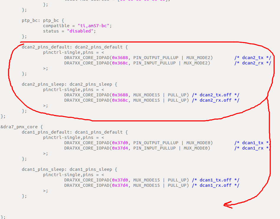

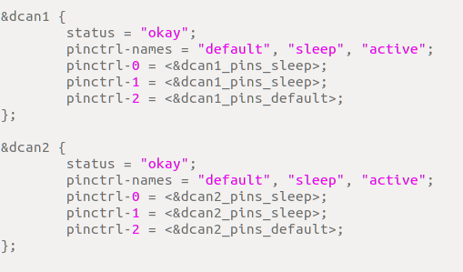

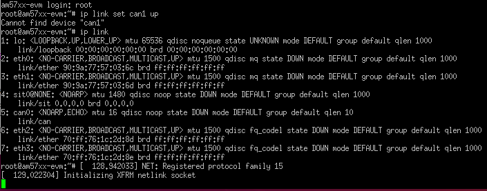

  • Hi Karan,
    I applied your patch and everything is ok. I mean I didn't see some errors. But I have a question maybe it should be in section &dra7_pmx_core???
    so we also see added code here:
    Ok let's see what we have in linux...
    Like you understood I rebuild .dtb and add new .dtb on my boot device(SD_card).
    Like you see we still didn't have can1 in system...
    BR,
    Oleg
  • Hi Oleg,
    Yes, the pinmux should be there inside the &dra7_pmx_core node. This will be needed for actual register address mapping from the offsets we provide. You can take reference from the patch I sent.
    You should see both the can interfaces. Can you check the dmesg and see if there was some error in the driver probe? run "dmesh | grep can" after the linux has booted. The interface does not depend on the Pinmux, if the node's status = okay in the device tree, I believe it should come up.
