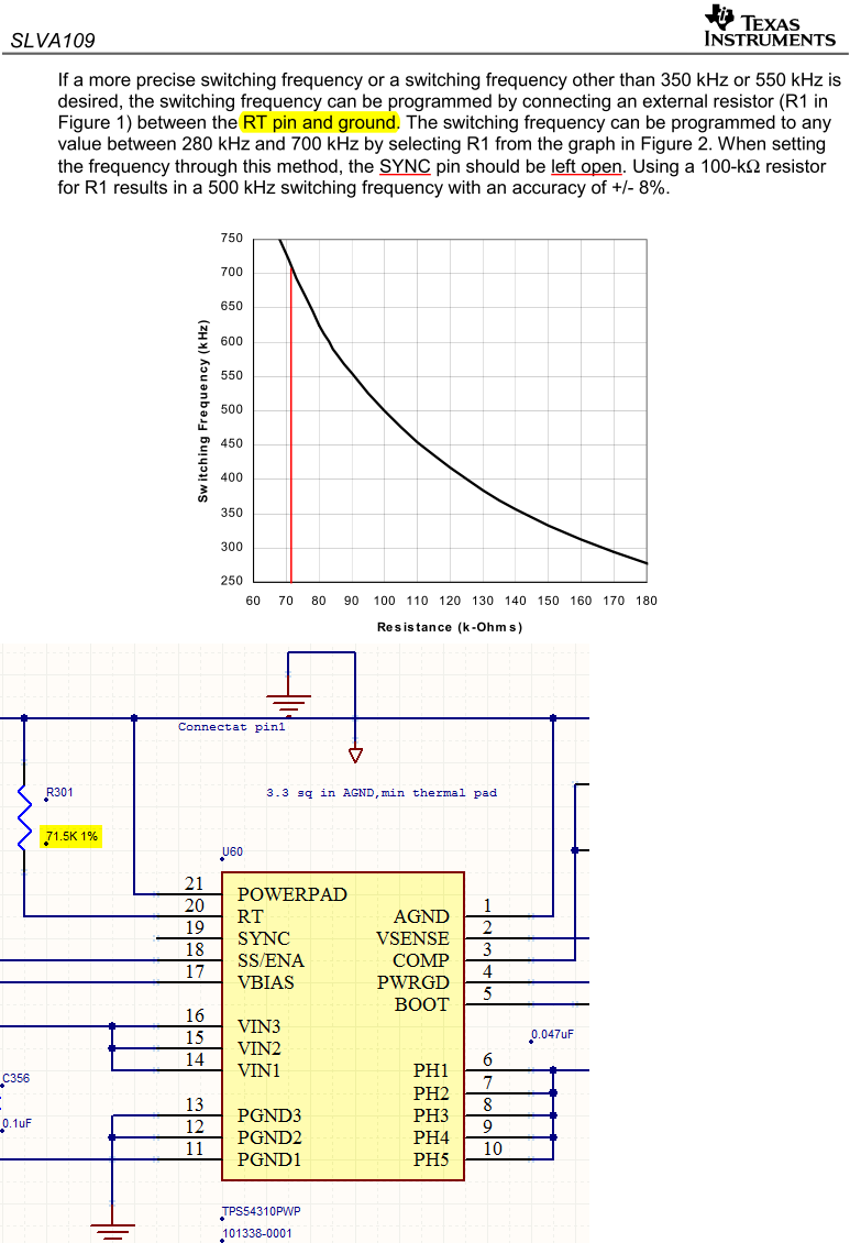

I would like to ask one question about TPS54310 switching frequency for EVM6437.
According to page 4 of SLVA109, Designing With the TPS54310 Synchronous Buck Regulator, when SYNC pin is left open and R1 pin is connected through a resistor to ground, then the switching frequency can be approximately obtained from Fig. 2
My question is why a switching frequency is needed? Is the DSP a DC or AC device? If it is a DC device, and from the Fig 2 we see that when resistor is 71.5K, the switching frequency is somewhere between 700 and 750 KHz. What is such a high switching frequency used for?
    The switching frequency is associated with the buck converter switching power supply technology and is not directly related to the DSP.
    To you specific question, the DSP requires a DC voltage.

    Understanding the topology of a buck converter SMPS will help you understand what these terms are.  Again, the above Wikipedia article will help provide a framework for the above terms.
