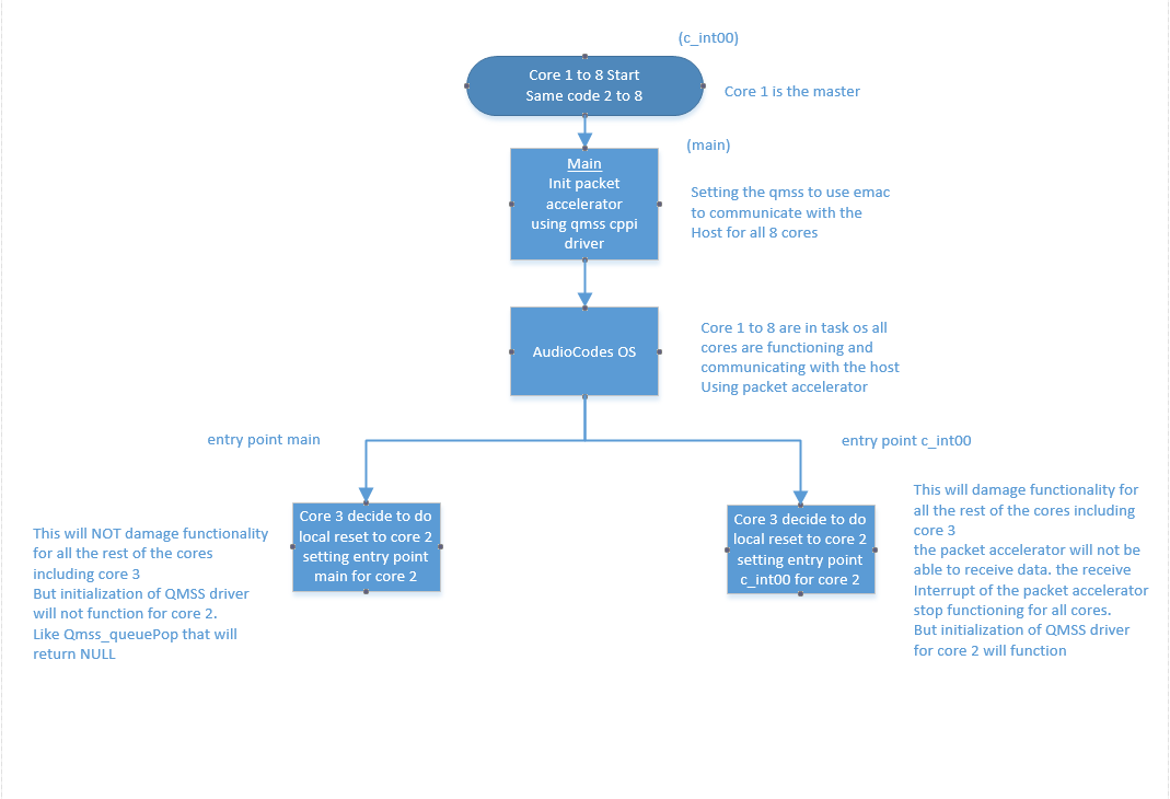

We are using all 8 cores of c6678 DSP with the same firmware apart from the first core which is
the master for the packet accelerator.
we are using system bios.
when a core is Initializing after a local reset the function Qmss_queuePop returns NULL.
Do we need to reset the qmss and how?
All other core should not be affected by that reset since they are using also the qmss.
when the reset vector of local reset is set to _c_int00, Qmss_queuePop will function well and not return NULL.
But when we set _c_int00 as the reset vector then all other cores are affected by the local reset.
what happens between c_int00 and main that causes the qmss to function like that?
