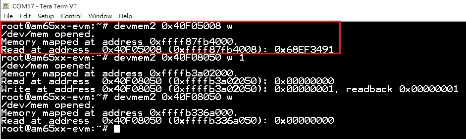

  • Joey,
    Can you read the MMR at 0x40F05008 and confirm the value when you are trying to write to 0x40f08050?
    Dave
  • Hi Dave,
    The value of 0x40F05008 is 0x68EF3491.
  • Joey,
    Thanks and apologies for the delay. I was without my platform but have it back now. I was suspecting at first that the MMRs were locked, and this last check was to confirm the lock status. It is, however, unlocked (UNLOCKED status is bit 0). I've since reproduced the same on my setup and see that I also cannot update this register with the devmem2 command, which is strange, and I do see this is working on the DRA829 with the same command. I'm following up to see what may be blocking and will update soon.
    Dave
