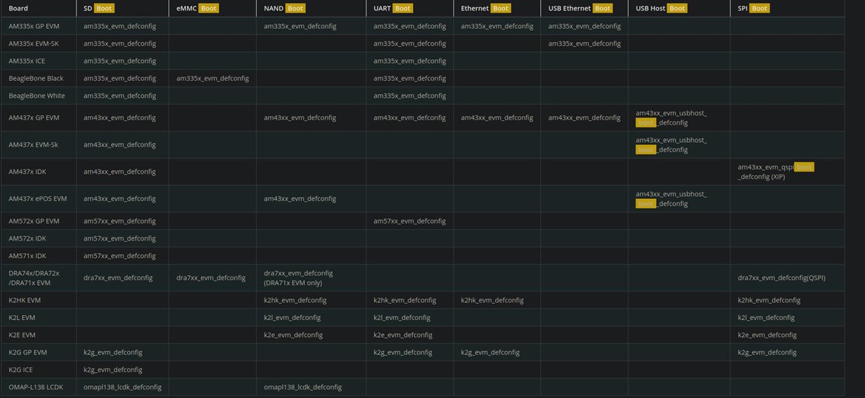

  • Also I didn't  see some special defconfig for am574x IDK... SPI Boot
