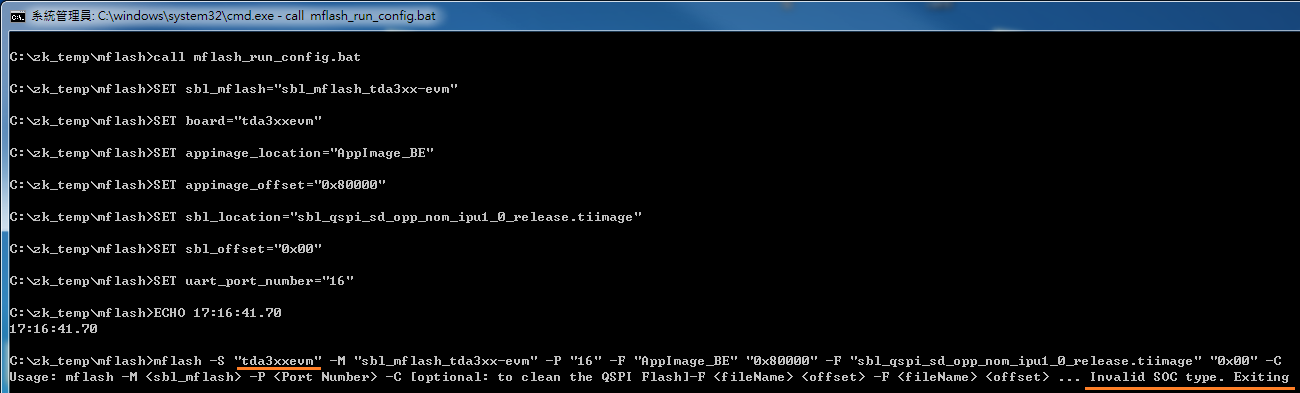

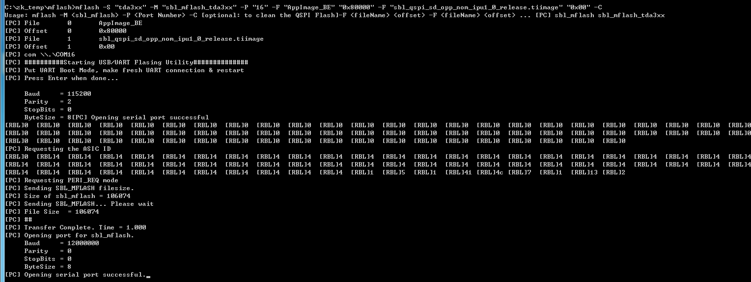

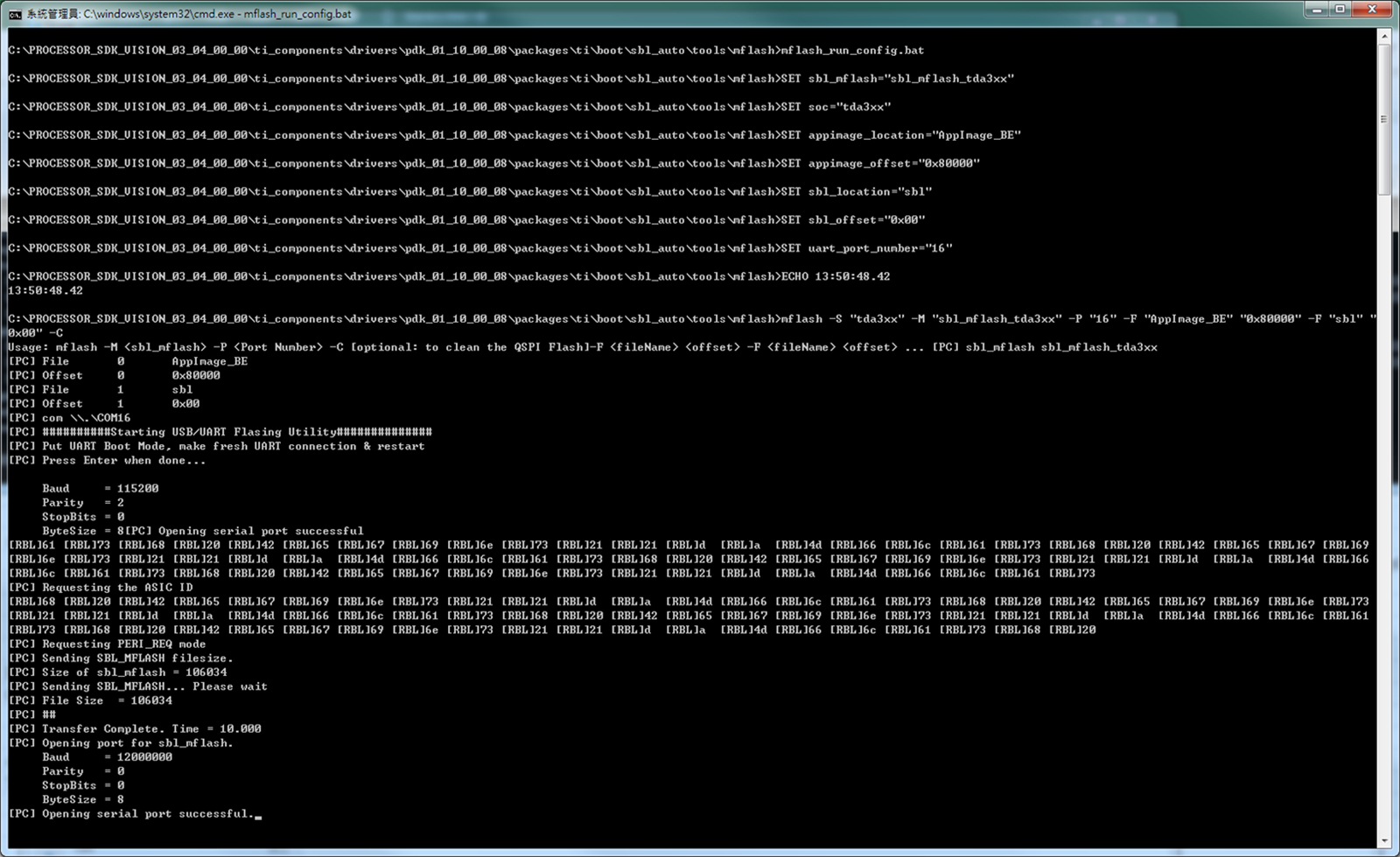

I'm running TI-RTOS Vision SDK v03.04 in the TDA3xx EVM board.
Tested on Windows7 & 10 64 bit PC.
Referenc: \pdk_01_10_00_08\packages\ti\boot\sbl_auto\tools\mflash\Readme.md
a. Change the sysboot switches SW2[0:7] and SW3[8:15] to [00010000][100000001] and SW8 to [01000001].
b. Finding the Correct COM Port Using Tera-Term.
The messages are the end up to here. There is no more progress.
Please let me know what I should do for the next?
