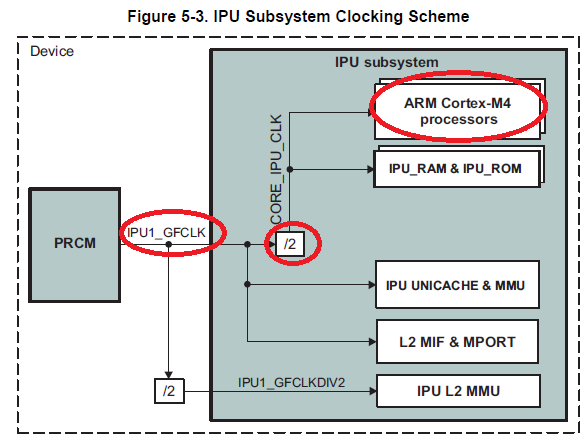

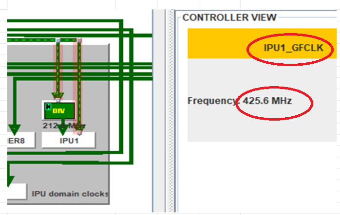

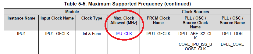

Hello Experts,
Is Max. ClockAllowed of IPU1_GFCLK 425.6MHz or 212.8MHz?
Per following table, it looks 212.8MHz.
However, it looks 425.6MHz from following figures.
Ken
  • The spec is 212.8 MHz for the actual processor clock rate.
    That is achieved with IPU1_GFCLK = 425.6 since  the /2 in the path provides 212.8 to the IPU core.
    I'll file a ticket to update the data manual accordingly.
