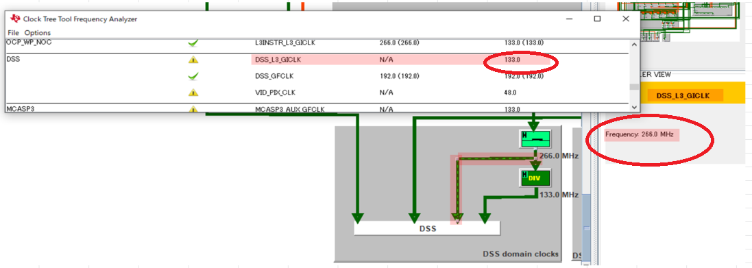

Hello Experts,
Frequency analyzer results and controller view of DSS_L3_GICLK show different values as follows.
Is there any way to avoid this mismatch? Is there any other clock which shows different frequency between Frequency analyzer results and controller view?
Ken
  • Ken,
    Sorry this looks like a bug in the tool.  I'm not aware of a way to avoid this.  In general TI provided software will set the appropriate settings for this (and similar) peripherals since this shouldn't be customized by the end user.
    Kyle
