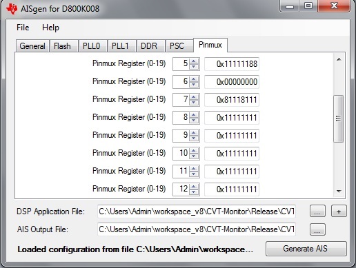

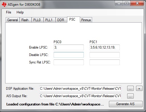

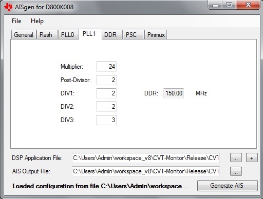

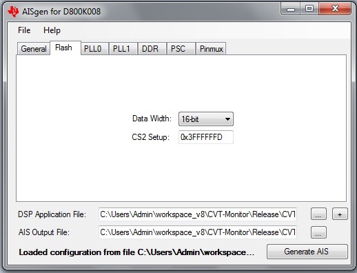

I am using TMS320c6748 dsp with Nor flash.
Actually in .cmd file DSPL2RAM i used it is booting from NOR FLASH, when i will change to DDR2 in .cmd it's not booting.
Because in .ccxml file i am adding c6748.gel file then all PLL & PSC and DDR initialized properly then it's booted from DDR2 in JTAG mode.
But it's not booting from NOR FLASH because how to add .gel file for (*.out)?
i am using AISGen same way i am loading?
But DSPL2RAM working then from DDR2 it's not working?
    If it's working over JTAG but not when booting from NOR flash, then indeed there is probably some initialization done by the GEL file that is not being done by the bootloader. Please compare your GEL file with your AISGen config settings for any differences or missing initializations. Also, please ensure you are not using a GEL file in your target configuration file (ccxml) when booting from NOR flash and subsequently connecting to the DSP core.
    Have you referred to the following bootloader application notes?
    OMAPL138/C6748 ROM Bootloader Resources and FAQ
    Using the TMS320C6748/C6746/C6742 Bootloader
    Sahin
  • Hai sir,
    Actually i have done below settings,
    and i am attaching my gel(OMAPL138_LCDK) file also sir,

    But through serial port not displaying any thing from DDR2 settings,
    from Internal DSPL2RAM it's working fine sir
