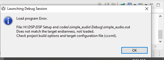

CCS/TMS320C6416T: Does not match the target endianness, not loaded
Part Number: TMS320C6416T
Problem/Error: "
Load Program Error.
...\\simple_audio\Debug\simple_audio.out
Does not match the target endianness, not loaded.
Check project build options and target configuration file (ccxml).
A little background:
I have a DSK6416T board and a customized board of DSK6416T.  In my customized board I have used the CPLD, SDRAM, FLASH etc, just as they are in the actual board while removing the UTOPIA, HPI interfaces as we didn't need that. I programmed the CPLD with TI provided VHDL code file just to make my customized board act like a DSK6416T when programming. I have cross checked all interfaces of CPLD and it's working like the DSK CPLD. It generates the CPU clock and EMIF clock perfectly.
What I am trying to do is to program a simple LED blink code into the customized board which works fine in the DSK6416t board but face the above mentioned error when I try to program the customized DSK6416T  board. I am using Texas Instruments XDS100v3 USB Debug Probe JTAG programmer to program both DSK and customized board. The endianness is set to Little on my customized board with the Sw1 set to 0.
I also observed the .GEL file when the CCS try to go into debug mode. It successfully executes the functions in below order:
StartUp()
OnTargetConnect()
OnReset()
OnPreFileLoaded()
and then gives the error on the console : Does not match the target......

One thing that I would like to mention is that my Flash and SDRAM are of from a different company in case if the problem is due to this reason.
DSP Kit SDRAM
MT48LC2M32B2P-6AAAT:JTR
AM29LV400BT-70EC
Customized board SDRAM
AS4C2M32SA-6TCN
MX29LV400CBTI-70G
Looking for any kind of help from experts. Thanks
