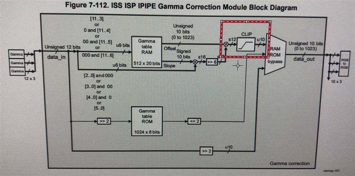

2. When IPIPE gamma is applied, the input data is 12 bits and the output is 10 bits. When checking the output through this process, the contour lines are visible in the infrared image. How do I get rid of this phenomenon?
 ->  In my opinion, when converting from 12 bits to 10 bits, 2 bits are lost, which is a problem. Is there any way to handle gamma without losing bits?

    I will try to explain again with pictures.
    As shown in the picture above, data is input in 12 bits. After that, it is output as 10 bits through the gamma table.
    Even if it does not pass through the gamma table, it is shifted by 2 bits.
    The picture below is when the gamma table is bypassed.
    When you look at the monitor, you see a contour line.

    The input format of IFIFE moudle is 12bit grayscale image.
    Below, I got answer in this forum for gamma module.
    I have a question about 12-bit input format.
    We get 12-bit data of the camera. But I think that the gamma module use only the msb 9bits in 12-bit data.
    What is the meaning of the 0x0005(the lsb 3bits) in the value 0x0B15?
    Could you let me know how to make 12 bit format
    For example, if you have a 12-bit input data with a value of 2837, which is 0xB15 in hex value, you'd first down-shift the data by 3 to get the index to the gamma look-up-table, which is 0x162 in this case, or 354 in decimal.The lsb 3bits of the data, which is 5, is upshifted by 3 to yield 40.
    Now assume your  gamma[354] entry has a offset value of 719 and a slope value of 2.
    The final output from the gamma table operation will then be:
    clip(719+((2*40)>>6)) = 720.
    Question2.
    So, i make up 12 bit data that the msb 9 bit data is camera data and the lsb 3 bit is 0.
    In this case, there is contour line in image, too.
    I think that this case is caused by the lost of lsb 3 bit.
    Am i wrong? If then, Could you let me know the reason? or How can I solve this problem?
    Question3.
    When I use the gamma module, the contrast of the image get lower compared to not using gamma module.
    i think that this problem is caused by the clip, 12bit to 10bit.
    Is this right? Then, how to i can solve?
    Actually, I need to used edge enhancer in IPIPE module.
    So I have to use gamma module in IPIPE module.
    If you have other solution, then let me know it, please.

  • Question 1:
    Your understanding is correct.
