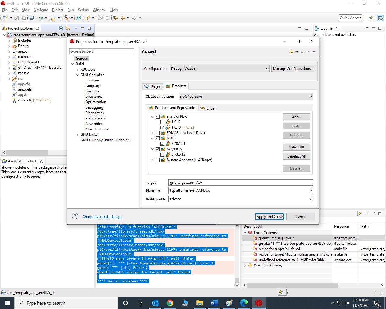

1) I want to use tcpecho example. how to generate project for the same?
2) what is the difference between
2.1)C:\ti\pdk_am437x_1_0_17\packages\ti\transport\ndk\nimu
and 2.2) C:\ti\pdk_am437x_1_0_17\packages\ti\transport\ndk\nimu_icss??
3) if i want to run tcpecho and other application along with EIP adapter functionality is it possible?
or do i have to create two different projcet (binaries) ?
4) How to add sntp example to EIP adapter project?

  • Vrund,
    1) You can start from processor_sdk_rtos_am437x_6_03_00_106\demos\rtos_template_app project and then add the tcpecho server example described in NDK API user guide section 5.4.2 Server Daemon Example to the project.
    2) \ndk\nimu is based on CPSW whearas the nimu_Icss is based on ICSS_EMAC.
    3) You can integrate the tcpecho into the EIP.
    4) Essentially you can use one of the methods below
    1. You want to use default NTP servers (SNTP_getTime(), with a NULL server list)
    2. You have the string names of one or more NTP servers (SNTP_getTime(), with your server list)
    3. You have the sockaddr of the NTP server (SNTP_getTimeByAddr(), with your sockaddr)
    as explained in file:///C:/ti/ns_2_40_01_02/docs/ns/html/group__ti__net__sntp__SNTP.html#details to the EIP project.
    Garrett
    -- I have created the project and add demon.c  example provided "C:\ti\ndk_3_40_01_01\packages\ti\ndk\nettools\daemon" but it is not getting build. below is the build log.
    **** Build of configuration Debug for project rtos_template_app_am335x_a8 ****
    "C:\\ti\\ccsv7\\utils\\bin\\gmake" -k -j 8 all -O
    gmake[1]: Entering directory 'C:/Users/vrund rana/workspace_v7/rtos_template_app_am335x_a8/Debug'
    'Building file: ../main.cfg'
    'Invoking: XDCtools'
    "C:/ti/xdctools_3_50_03_33_core/xs" --xdcpath="C:/ti/bios_6_73_00_12/packages;C:/ti/pdk_am335x_1_0_12/packages;C:/ti/ccsv7/ccs_base;" xdc.tools.configuro -o configPkg -t gnu.targets.arm.A8F -p ti.platforms.evmAM3359 -r release -c "C:/ti/gcc-arm-none-eabi-6-2017-q1-update" "../main.cfg"
    making package.mak (because of package.bld) ...
    generating interfaces for package configPkg (because package/package.xdc.inc is older than package.xdc) ...
    configuring main.xa8fg from package/cfg/main_pa8fg.cfg ...
    generating custom ti.sysbios library makefile ...
    Linking with library ti.drv.spi:./lib/am335x/a8/release/ti.drv.spi.aa8fg
    Linking with library ti.drv.uart:./lib/am335x/a8/release/ti.drv.uart.aa8fg
    Linking with library ti.drv.i2c:./lib/am335x/a8/release/ti.drv.i2c.aa8fg
    Linking with library ti.csl:./lib/am335x/a8/release/ti.csl.aa8fg
    Linking with library ti.osal:./lib/tirtos/a8/release/ti.osal.aa8fg
    Starting build of library sources ...
    making C:/Users/VRUNDR~1/workspace_v7/rtos_template_app_am335x_a8/src/sysbios/sysbios.aa8fg ...
    gmake[1]: Entering directory `C:/Users/VRUNDR~1/workspace_v7/rtos_template_app_am335x_a8/src/sysbios'
    gmake[1]: Nothing to be done for `all'.
    gmake[1]: Leaving directory `C:/Users/VRUNDR~1/workspace_v7/rtos_template_app_am335x_a8/src/sysbios'
    Build of libraries done.
    cla8fg package/cfg/main_pa8fg.c ...
    'Finished building: ../main.cfg'
    gmake[1]: Leaving directory 'C:/Users/vrund rana/workspace_v7/rtos_template_app_am335x_a8/Debug'
    'Building file: ../daemon.c'
    'Invoking: GNU Compiler'
    "C:/ti/gcc-arm-none-eabi-6-2017-q1-update/bin/arm-none-eabi-gcc.exe" -c -mcpu=cortex-a8 -mtune=cortex-a8 -march=armv7-a -marm -mfloat-abi=hard -Dam3358 -DevmAM335x -DSOC_AM335x -I"C:/Users/vrund rana/workspace_v7/rtos_template_app_am335x_a8" -I"C:/ti/gcc-arm-none-eabi-6-2017-q1-update/arm-none-eabi/include" -g -gdwarf-3 -gstrict-dwarf -Wall -MMD -MP -MF"daemon.d" -MT"daemon.o" -o"daemon.o" @"configPkg/compiler.opt" "../daemon.c"
    subdir_rules.mk:9: recipe for target 'daemon.o' failed
    ../daemon.c:42:21: fatal error: netmain.h: No such file or directory
     #include <netmain.h>
    compilation terminated.
    gmake: *** [daemon.o] Error 1
    'Building file: ../main.c'
    "C:/ti/gcc-arm-none-eabi-6-2017-q1-update/bin/arm-none-eabi-gcc.exe" -c -mcpu=cortex-a8 -mtune=cortex-a8 -march=armv7-a -marm -mfloat-abi=hard -Dam3358 -DevmAM335x -DSOC_AM335x -I"C:/Users/vrund rana/workspace_v7/rtos_template_app_am335x_a8" -I"C:/ti/gcc-arm-none-eabi-6-2017-q1-update/arm-none-eabi/include" -g -gdwarf-3 -gstrict-dwarf -Wall -MMD -MP -MF"main.d" -MT"main.o" -o"main.o" @"configPkg/compiler.opt" "../main.c"
    'Finished building: ../main.c'
    'Building file: ../app.c'
    "C:/ti/gcc-arm-none-eabi-6-2017-q1-update/bin/arm-none-eabi-gcc.exe" -c -mcpu=cortex-a8 -mtune=cortex-a8 -march=armv7-a -marm -mfloat-abi=hard -Dam3358 -DevmAM335x -DSOC_AM335x -I"C:/Users/vrund rana/workspace_v7/rtos_template_app_am335x_a8" -I"C:/ti/gcc-arm-none-eabi-6-2017-q1-update/arm-none-eabi/include" -g -gdwarf-3 -gstrict-dwarf -Wall -MMD -MP -MF"app.d" -MT"app.o" -o"app.o" @"configPkg/compiler.opt" "../app.c"
    'Finished building: ../app.c'
    gmake: Target 'all' not remade because of errors.
    **** Build Finished ****
    Kindly suggest.

    I have created project NIMU_ICSS_BasicExample_iceAMIC110_wSoCLib_armExampleproject
    I can see nethook.c file is already added.
    and it has
    void netOpenHook()
    // Create our local servers
    hEcho = DaemonNew( SOCK_STREAMNC, 0, 7, dtask_tcp_echo,
    OS_TASKPRINORM, OS_TASKSTKNORM, 0, 3 );
    hEchoUdp = DaemonNew( SOCK_DGRAM, 0, 7, dtask_udp_echo,
    OS_TASKPRINORM, OS_TASKSTKNORM, 0, 1 );
    hData = DaemonNew( SOCK_STREAM, 0, 1000, dtask_tcp_datasrv,
    hNull = DaemonNew( SOCK_STREAMNC, 0, 1001, dtask_tcp_nullsrv,
    hOob = DaemonNew( SOCK_STREAMNC, 0, 999, dtask_tcp_oobsrv,
    void netCloseHook()
    DaemonFree(hOob);
    DaemonFree(hNull);
    DaemonFree(hData);
    DaemonFree(hEchoUdp);
    DaemonFree(hEcho);
    which file can i add tcpecho code from NDK API user guide section 5.4.2 Server Daemon Example to the project?

  • It doesn't seem you have NDK library linked in your project build. Please refer to a NIMU example project in the PDK to see how NDK modules are included in the .cfg file, e.g. packages\ti\transport\ndk\nimu_icss\example\am335x\armv7\bios\am335x_app_icev2_wSoCLib.cfg
    Garrett
    I have added ndk library as below mention in ndk guide.
    1.6.1 Adding NDK Support to an Existing Application If you have an existing application that has SYS/BIOS and XDCtools support, but does not have either TIRTOS or the NDK enabled, follow these steps to enable the NDK and NSP: 1. Right-click on the CCS project in the Project Explorer view. Choose Show Build Settings from the context menu. 2. Select the General category in the Properties dialog. 3. Go to the RTSC tab. 4. Check the boxes next to the most recently installed versions of the NDK and NDK Network Support Package products. 5. Click OK. 6. Reopen the *.cfg file in the project with XGCONF. The NDK and NSP should now be listed in the Available Products view if you expand TI-RTOS > Products. 7. Select the NDK > Global item in the Available Products view. Right-click on the Global module and select Use Global. You will see the Welcome sheet for NDK configuration. This sheet provides an overview of the NDK, configuration information, and documentation for the NDK. 8. Click the System Overview link at the top of the Welcome sheet to see a handy diagram of the NDK modules you can configure. 9. Right-click on the Emac module in the System Overview diagram and choose Use Emac. To configure the Emac module, select the device for which you are building. The Emac module will attempt to load the Ethernet driver for that device. If the device you are working with is not in the list, choose "NONE" as the device. In this case, you must link in your device's
    Ethernet driver yourself. 10. Open the project's Properties dialog and go to the Build > Compiler > Include Options category. Add ${NDK_INSTALL_DIR}/packages/ti/ndk/inc to your application's compiler include path.
    but still i am getting error.

    cla9fg package/cfg/main_pa9fg.c ...
    In file included from C:/ti/ndk_3_40_01_01/packages/ti/ndk/inc/socket.h:43:0,
    from C:/ti/ndk_3_40_01_01/packages/ti/ndk/inc/stacksys.h:86,
    from C:/ti/ndk_3_40_01_01/packages/ti/ndk/inc/netmain.h:39,
    from package/cfg/main_pa9fg.c:2593:
    C:/ti/ndk_3_40_01_01/packages/ti/ndk/inc/socketndk.h:94:0: warning: "_SYS_SELECT_H" redefined
    #define _SYS_SELECT_H 1 // TODO: still needed for struct timeval conflict
    In file included from c:\ti\bios_6_73_00_12\packages\gnu\targets\arm\libs\install-native\arm-none-eabi\include\sys\types.h:68:0,
    from c:\ti\bios_6_73_00_12\packages\gnu\targets\arm\libs\install-native\arm-none-eabi\include\time.h:28,
    from package/cfg/main_pa9fg.c:2553:
    c:\ti\bios_6_73_00_12\packages\gnu\targets\arm\libs\install-native\arm-none-eabi\include\sys\select.h:13:0: note: this is the location of the previous definition
    Finished building: "../main.cfg"
    Building file: "../GPIO_evmAM437x_board.c"
    "C:/ti/ccs930/ccs/tools/compiler/gcc-arm-none-eabi-7-2017-q4-major-win32/bin/arm-none-eabi-gcc-7.2.1.exe" -c -mcpu=cortex-a9 -march=armv7-a -mtune=cortex-a9 -marm -mfloat-abi=hard -Dam4372 -DSOC_AM437x -DEVM_AM437X -DevmAM437x -I"C:/ti/ndk_3_40_01_01/packages/ti/ndk/inc" -I"C:/Users/20033229/workspace_v9/rtos_template_app_am437x_a9" -I"C:/ti/ccs930/ccs/tools/compiler/gcc-arm-none-eabi-7-2017-q4-major-win32/arm-none-eabi/include" -Og -g -gdwarf-3 -gstrict-dwarf -Wall -MMD -MP -MF"GPIO_evmAM437x_board.d" -MT"GPIO_evmAM437x_board.o" @"configPkg/compiler.opt" -o"GPIO_evmAM437x_board.o" "../GPIO_evmAM437x_board.c"
    Finished building: "../GPIO_evmAM437x_board.c"
    Building file: "../daemon.c"
    "C:/ti/ccs930/ccs/tools/compiler/gcc-arm-none-eabi-7-2017-q4-major-win32/bin/arm-none-eabi-gcc-7.2.1.exe" -c -mcpu=cortex-a9 -march=armv7-a -mtune=cortex-a9 -marm -mfloat-abi=hard -Dam4372 -DSOC_AM437x -DEVM_AM437X -DevmAM437x -I"C:/ti/ndk_3_40_01_01/packages/ti/ndk/inc" -I"C:/Users/20033229/workspace_v9/rtos_template_app_am437x_a9" -I"C:/ti/ccs930/ccs/tools/compiler/gcc-arm-none-eabi-7-2017-q4-major-win32/arm-none-eabi/include" -Og -g -gdwarf-3 -gstrict-dwarf -Wall -MMD -MP -MF"daemon.d" -MT"daemon.o" @"configPkg/compiler.opt" -o"daemon.o" "../daemon.c"
    from ../daemon.c:42:
    from c:\ti\bios_6_73_00_12\packages\gnu\targets\arm\libs\install-native\arm-none-eabi\include\sys\time.h:43,
    from C:/ti/ndk_3_40_01_01/packages/ti/ndk/inc/socketndk.h:48,
    from C:/ti/ndk_3_40_01_01/packages/ti/ndk/inc/socket.h:43,
    Finished building: "../daemon.c"
    Building file: "../app.c"
    "C:/ti/ccs930/ccs/tools/compiler/gcc-arm-none-eabi-7-2017-q4-major-win32/bin/arm-none-eabi-gcc-7.2.1.exe" -c -mcpu=cortex-a9 -march=armv7-a -mtune=cortex-a9 -marm -mfloat-abi=hard -Dam4372 -DSOC_AM437x -DEVM_AM437X -DevmAM437x -I"C:/ti/ndk_3_40_01_01/packages/ti/ndk/inc" -I"C:/Users/20033229/workspace_v9/rtos_template_app_am437x_a9" -I"C:/ti/ccs930/ccs/tools/compiler/gcc-arm-none-eabi-7-2017-q4-major-win32/arm-none-eabi/include" -Og -g -gdwarf-3 -gstrict-dwarf -Wall -MMD -MP -MF"app.d" -MT"app.o" @"configPkg/compiler.opt" -o"app.o" "../app.c"
    Finished building: "../app.c"
    Building file: "../main.c"
    "C:/ti/ccs930/ccs/tools/compiler/gcc-arm-none-eabi-7-2017-q4-major-win32/bin/arm-none-eabi-gcc-7.2.1.exe" -c -mcpu=cortex-a9 -march=armv7-a -mtune=cortex-a9 -marm -mfloat-abi=hard -Dam4372 -DSOC_AM437x -DEVM_AM437X -DevmAM437x -I"C:/ti/ndk_3_40_01_01/packages/ti/ndk/inc" -I"C:/Users/20033229/workspace_v9/rtos_template_app_am437x_a9" -I"C:/ti/ccs930/ccs/tools/compiler/gcc-arm-none-eabi-7-2017-q4-major-win32/arm-none-eabi/include" -Og -g -gdwarf-3 -gstrict-dwarf -Wall -MMD -MP -MF"main.d" -MT"main.o" @"configPkg/compiler.opt" -o"main.o" "../main.c"
    Finished building: "../main.c"
    Building target: "rtos_template_app_am437x_a9.out"
    Invoking: GNU Linker
    "C:/ti/ccs930/ccs/tools/compiler/gcc-arm-none-eabi-7-2017-q4-major-win32/bin/arm-none-eabi-gcc-7.2.1.exe" -mtune=cortex-a9 -marm -Dam4372 -DSOC_AM437x -DEVM_AM437X -DevmAM437x -Og -g -gdwarf-3 -gstrict-dwarf -Wall -mfloat-abi=hard -Wl,-Map,"rtos_template_app_am437x_a9.map" -nostartfiles -static -Wl,--gc-sections -L"C:/ti/pdk_am437x_1_0_12/packages/ti/board/lib/evmAM437x/a9/release/" -L"C:/ti/bios_6_73_00_12/packages/gnu/targets/arm/libs/install-native/arm-none-eabi/lib/hard" -Wl,--defsym,STACKSIZE=0x18000 -Wl,--defsym,HEAPSIZE=0x400 --specs=nano.specs -o"rtos_template_app_am437x_a9.out" "./GPIO_evmAM437x_board.o" "./app.o" "./daemon.o" "./main.o" -Wl,-T"configPkg/linker.cmd" -Wl,--start-group -l:ti.board.aa9fg -lgcc -lm -lrdimon -lc -Wl,--end-group
    makefile:149: recipe for target 'rtos_template_app_am437x_a9.out' failed

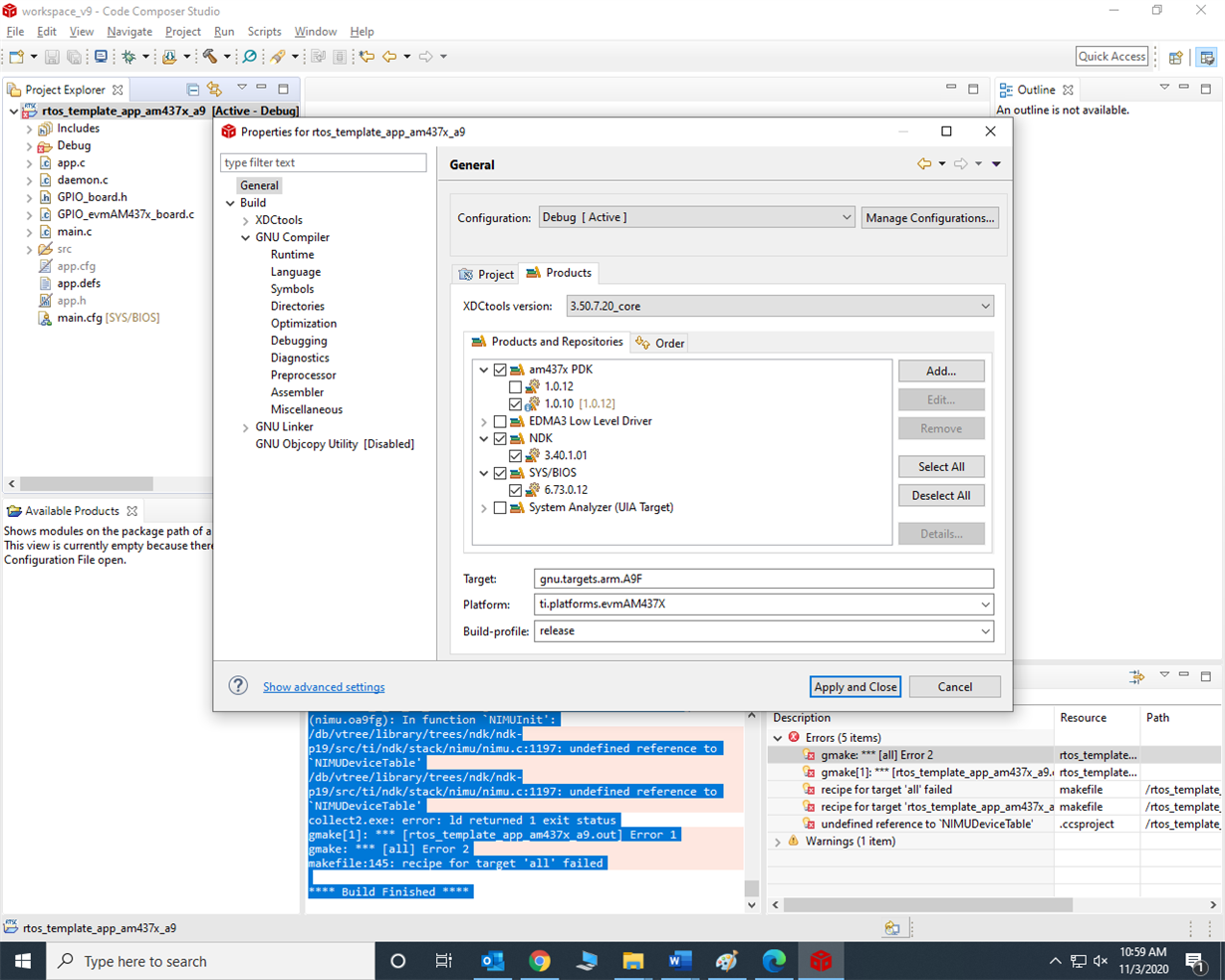

    C:\ti\ndk_3_40_01_01\packages\ti\ndk\stack\lib\stk6.aa9fg(nimu.oa9fg): In function `NIMUInit':
    /db/vtree/library/trees/ndk/ndk-p19/src/ti/ndk/stack/nimu/nimu.c:1197: undefined reference to `NIMUDeviceTable'
    collect2.exe: error: ld returned 1 exit status
    gmake[1]: *** [rtos_template_app_am437x_a9.out] Error 1
    gmake: *** [all] Error 2
    makefile:145: recipe for target 'all' failed
  • Refer to
    Garrett
    I have gone through the details and able to build the project.
    Vrund
