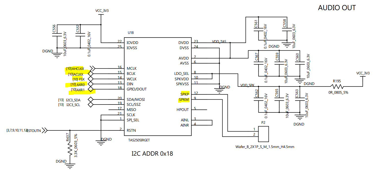

I use SDK03_05  Rtos on the custom board.
I need analog audio output to speakers.
Is there an example of using TAS2505 on TDA2XX?

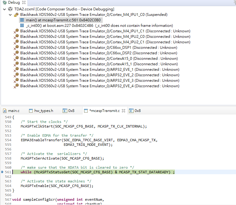

    I use csl mcaspTransmit.c.
    The modified code is as below

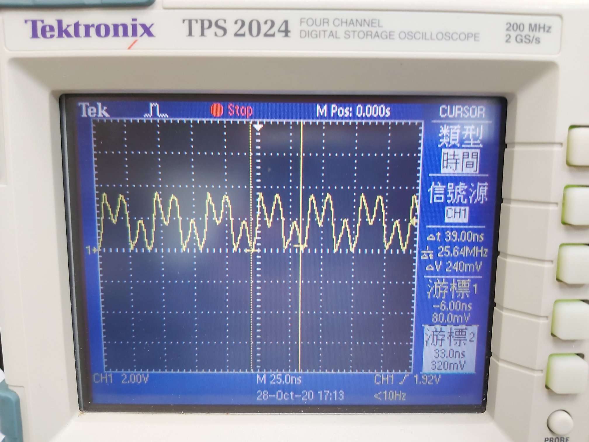

    I found the mcasp1_ahclk waveform is very strange.

    This is TAS2505 circuit diagram
    I refer to TAS2505 Application Reference Guide page 49 4.0.7 Example Register Setup to Play Digital Data Through DAC and Headphone/Speaker Outputs, and TAS2505 module has been initialized
  • I changed the slot size from 32U to 16U, and the word size from 32U to 16U according to the example.
    The program loops in while (McASPTxStatusGet(SOC_MCASP_CFG_BASE) & MCASP_TX_STAT_DATAREADY); did not leave.
  • The souce code mentioned in the above message is here

    static void I2SDataTxActivate(void)
        /* Start the clocks */
        McASPTxClkStart(SOC_MCASP_CFG_BASE, MCASP_TX_CLK_INTERNAL);
        /* Enable EDMA for the transfer */
        EDMA3EnableTransfer(SOC_EDMA_TPCC_BASE_VIRT, EDMA3_CHA_MCASP_TX,
                            EDMA3_TRIG_MODE_EVENT);
        /* Activate the  serializers */
        McASPTxSerActivate(SOC_MCASP_CFG_BASE);
        /* make sure that the XDATA bit is cleared to zero */
        while (McASPTxStatusGet(SOC_MCASP_CFG_BASE) & MCASP_TX_STAT_DATAREADY) ;
        /* Activate the state machines */
        McASPTxEnable(SOC_MCASP_CFG_BASE);

    (1)The measured AHCLK waveform is correct, but TAS2505 requires MCLK should be 11.2896MHz.
    The following 0x25 configuration is more connected, is this value correct?
    //#define MCASP_AHCLKX_HCLKXDIV_VALUE (0x5U) //75MHZ
    //#define MCASP_AHCLKX_HCLKXDIV_VALUE (0x10U) //25MHZ
    //#define MCASP_AHCLKX_HCLKXDIV_VALUE (0x22U) //12.79MHZ
    //#define MCASP_AHCLKX_HCLKXDIV_VALUE (0x23U) //12.28MHZ
    #define MCASP_AHCLKX_HCLKXDIV_VALUE (0x24U) //11.88MHZ
    //#define MCASP_AHCLKX_HCLKXDIV_VALUE (0x25U) //11.54MHZ
    (2)I have problems adjusting slot size word size, Please help solve.
    (3)Can i read *.wav  in the sd card to play audio use TAS2505 and speaker?
    I haven't received a response from TI for a while
    BR
    Tim
