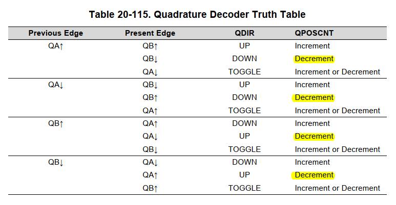

I have some questions regarding to the eQEP module per Sitara AM4376. The document I referred to is
For my application, only QEPA and QEPB signals are used.

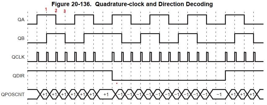

So for Quadrature Count Mode,
I want to use Table 20-115, the truth table
to interpret Figure 20-136
Then,
1, QDIR=’1’ means UP in truth table?
2, ‘+1’ means increment and ‘-1’ means decrement in truth table?

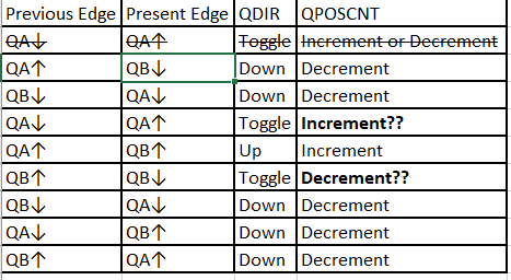

3, take QCLK 1, 2, 3 for example(marked in read in above screen short-cut), then according to the truth table, I can get such excel sheet
Previous Edge
Present Edge
QDIR
QPOSCNT
QA↑
QB↑
Up
Increment
QB↑
QA↓
Up
Decrement
QA↓
QB↑
Down
Decrement
I supposed that the row marked in red there should be UP/Increment. And ‘Down/Decrement’ = ‘UP/increment’ ??
The truth table just seems wrong to me.
Could you please help?
thanks!
Denny

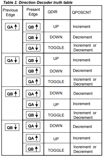

    Thank you for your patience, upon review, you are correct, this truth table is incorrect in the documentation. A bug will be filed for correction.
    Until the docs are updated please use the table below which matches your description.
    Let me know if you any further questions,

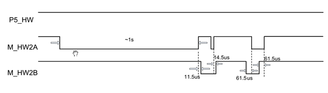

  • Hello, Fleenor,
    Actually Denny is helping me posting the questions.
    and I do have one more.
     is ' Up increment' = 'Down decrement'?
    and how to interpret below waveforms exactly? the result according to the truth table you provide still can't match my real case.
    Steven
  • Yes,
    QDIR:UP = QPOSCNT:Increment
    QDIR:DOWN = QPOSCNT:Decrement
    I would need more background on the waveform you provided to provide valid feedback. Is there a clock signal? What does the P5_HW, M_HW2A, and M_HW2B signals represent?
  • Hello, Fleenor,
    You can ignore the signal P5_HW. M_HW2A represents QEPA and M_HW2B represents QEPB. there are no corresponding signals to Index or strobe for my application.
    The eQEP functionality is fully on before the 1st edge found on M_HW2A.
    I made a sketch according to your truth table. Somehow it seems not match my system software interpretation to the waveforms, 'one digit bit decrease(or one bit increase in reverse direction)'

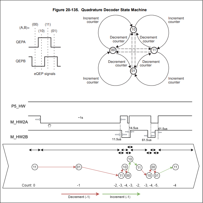

  • Hello Steven,
    Please see diagram below that used the EQEP State Machine to decode the EQEP Counter results based on state changes of your sample signal.
