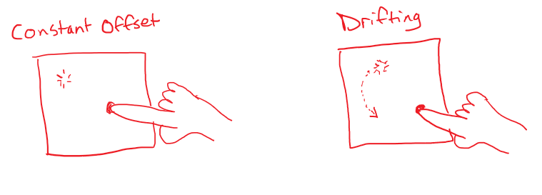

  • Hello Shine,
    To double check: Are the coordinates that the touchscreen registers just offset from the actual touch location? (in other words, if they touch in the same place are the registered coordinates about the same?) Or do the coordinates actually move around significantly relative to the actual touch location? (that is what I would call drift). The customer can use evtest to check coordinates from the command line. We also suggest using a stylus instead of a finger for increased accuracy.
    If the customer is just seeing a constant offset when touching the exact same point, then I would suspect that they need to recalibrate the touchscreen as per How to Recalibrate the Touchscreen
    Could the user take a picture of their touchscreen so we can see how it is attached?
    Nick

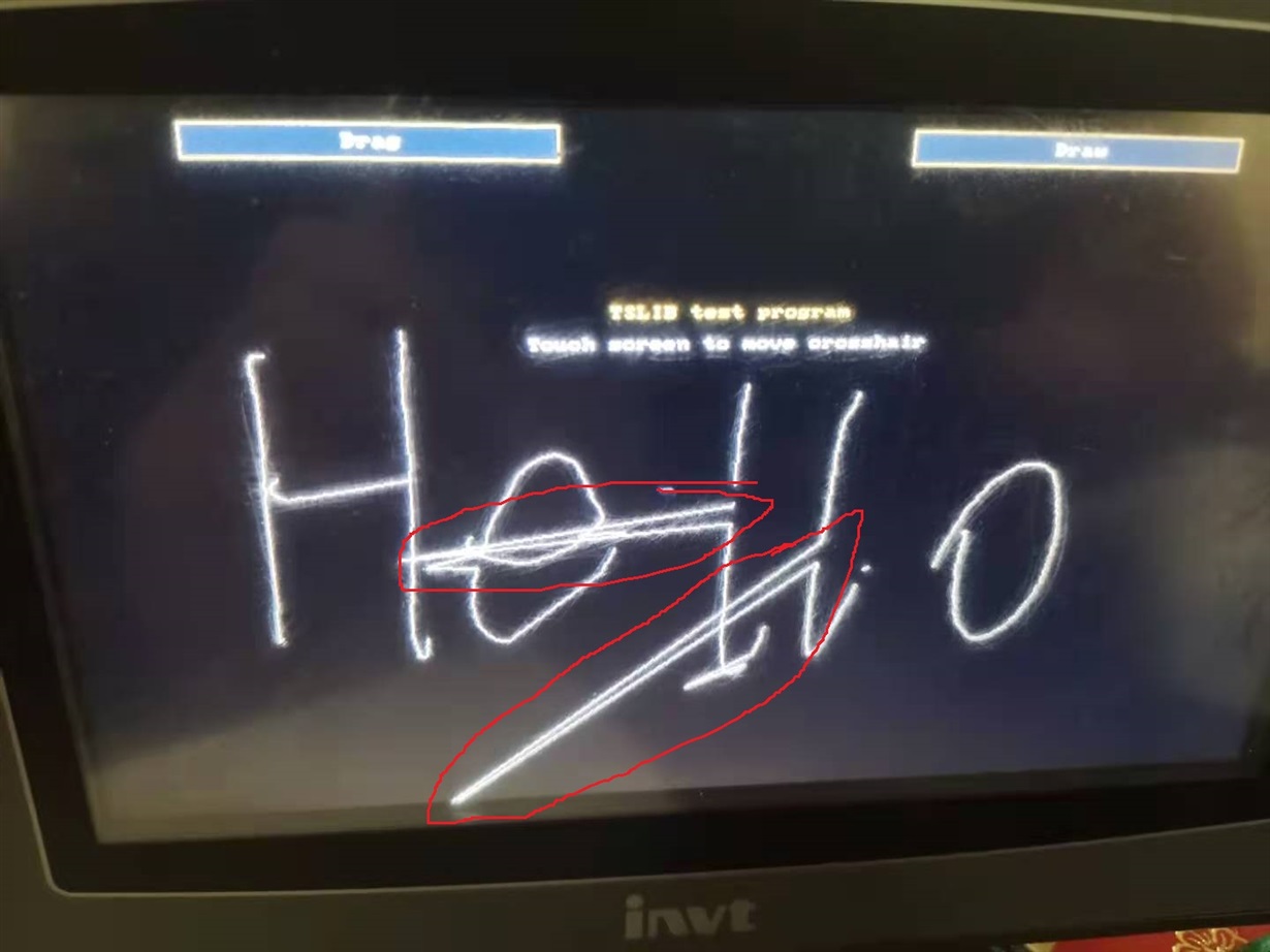

  • Hi Nick,
    Thank you very much for your support.
    Below is the picture from customer, he used ts_test to write "hello", the red high lighted is the shifting.
    Thanks.
    Rgds
    Shine
  • Hello Shine,
    Ok, I see. So most of the time the touch events are where the customer is touching, but once in a while a touch will register somewhere else.
    I would first test to see if the customer is seeing false pen-up events. Have the customer modify the device tree file > &tscadc > tsc node, property "ti,charge-delay". Experiment with different values and see if they can get the touchscreen to start behaving. Reference Documentation/devicetree/bindings/input/touchscreen/ti-tsc-adc.txt.
    Nick
