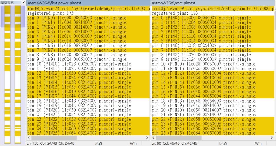

Our customer board use OSPI boot and load rootfs form eMMC.
And in Linux part, we already have some pinmux settings for our customer board.
Right now, we try to enable our customer's camera with Linux+RTOS 7.0 version. and we meet a issue.
We find there are many pinmux config are different as our settings.
  • When we first power-on our customer board, our 11c000.pinmux table is version A(this version is our linux pinmux config), as this file.
    root@j7-evm:~# cat /sys/kernel/debug/pinctrl/11c000.pinmux-pinctrl-single/pins

  • but after we reboot the board by reboot command in main-uart. The pinmux table will became B version, as this file

So I compare some situation, and I find the root cause of pinmux table version A and version B is depend on is there a j7-main-r5f0_0-fw in /lib/firmware/ when we reboot.
If I rename or directly delete the /lib/firmware/j7-main-r5f0-0-fw, and then reboot. the pinmux table will always keep on version A.

2. I study the doc , and try to follow to disable origin addon board pinmux config.
below is my steps:
1. Modify Board_pinmuxConfig function in 'packages/ti/board/src/j721e_evm/board_pinmux.c' file
2. Modify SRCS_COMMON parameter in 'packages/ti/board/src/j721e_evm/src_files_j721e_evm.mk' file, and delete three files(J721E_pinmux_data_info.c J721E_pinmux_data_gesi.c J721E_pinmux_data_gesi_cpsw9g.c)
3. Rebuild board library $ cd psdkra/pdk_jacinto_07_00_00/packages/ti/build
    $ make -s allclean
    $ make -s allcores BOARD=j721e_evm
4. Rebuild Vision_Apps
    $ cd psdkra/vision_apps
    $ make vision_apps_clean
    $ make vision_apps
    $ make linux_fs_install
I flash the new files which in psdkra/targetfs folder to my eMMC rootfs partition.
But the 11c000.pinmux table is still like version B after we reboot the board.
It seem my modify didn't work.
Can you also help to check my steps, did I miss any thing?

  • Hi Keerthy:
    • booting from SD card & file system also in SD card?
    Ans : I try two way "booting and load file-system form SD card" and "OSPI boot+load rootfs form eMMC" on TI-EVM board, it seem the our customer board's situation didn't happen on TI-EVM board.
    but I get one error when I try below steps no matter which boot way.
    I got two verison of pinmux table on TI-EVM board, veriosn A is only linux part

    , version B is linux + j7-main-r5f0_0-fw

    1. When I power-on TI-EVM board without /lib/firmware/j7-main-r5f0_0-fw, I can get version A pinmux table.
    2. Then I put j7-main-r5f0_0-fw file into /lib/firmware/, and reboot TI-EVM board.
    3. After reboot, I can get version B pinmux table.
    4. Then I delete the /lib/firmware/j7-main-r5f0_0-fw, and reboot TI-EVM board.
    5. After reboot, I can get a almost pinmux like version B, except PIN105 and PIN151. I think it should like version A, not like version B.
    6. I shudown-down TI-EVM board first, and then repower-on it. I can get version A pinmux table after boot.
    I can't understand why pinmux still keep on linux+j7-main-r5f0_0-fw version even I already delete the j7-main-r5f0_0-fw file.
    BTW, our customer board didn't have SD card, so I can't test the SD card flow on our customer board.
    • disable origin addon board pinmux config in RTOS
    Ans: I find there is one file (packages/ti/drv/cpsw/examples/cpsw_apputils/V1/cpsw_board_pinmux.c) also use  gJ721E_MainPinmuxDataGesiCpsw9gQsgmii pinmux. After I also disable this part function, and rebuild j7-main-r5f0_0-fw, now I can see most  pinmux keep on my linux config when I reboot our customer board.

  • Hi Brijesh:
    • can you please check what all firmwares are present in the /lib/firmware folder?
      ==> Yes, we already make sure those firmware files (j7-main-r5f0_0-fw / j7-c66_0-fw / j7-c66_1-fw / j7-c71_0-fw) already flash into /lib/firmware/ folder on our eMMC.
    •  which pins pinmux values are changing?
      ==> Yes, some pins we need to control (like GPIO0_75/GPIO0_76/....) are different between first power-on and after reboot.
      GPIO0_75:
      First Power-on : pin 76 (PIN76) 11c130 00050007 pinctrl-single
      After Reboot   : pin 76 (PIN76) 11c130 00010004 pinctrl-single
      GPIO0_76:
      First Power-on : pin 77 (PIN77) 11c134 00050007 pinctrl-single
      After Reboot   : pin 77 (PIN77) 11c134 00010004 pinctrl-single
    Not only the two pins different, you can see below compare picture,
    Now we already know how to config pins to correct pinmux in firmware part,
    but the real problem of why different between first power-on and after reboot is still alive.
    BR
    Sentinen Chen
