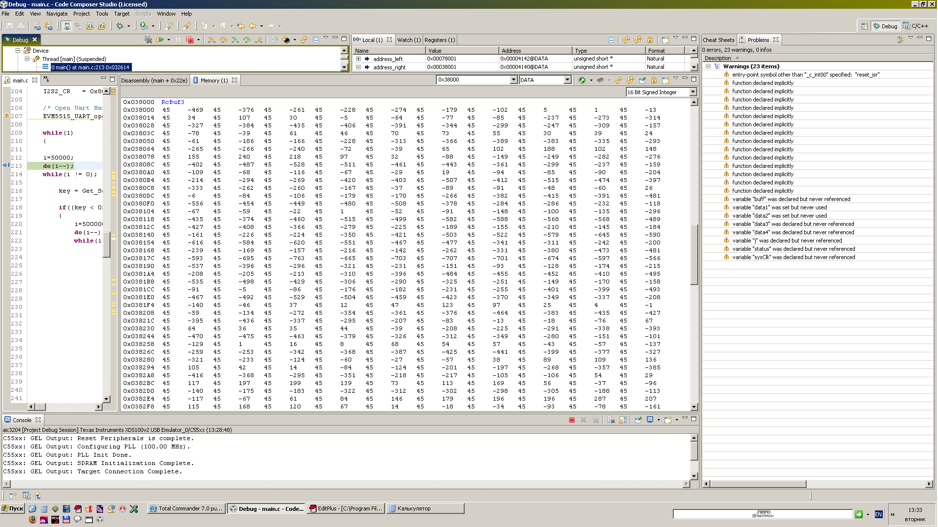

Data representation in the memory
This is my simple code, witch sample by sample transfer audio from I2S module to SDRAM.

In general program works fine. Data store and playback sounds nice.
But when I at any time stop program execution and look to memory I see strange situation.
Screenshot of memory window is attached.
All even samples are constant.
Why it's so?

    Can you write any value to even location in the memory to check whether you can write something to it?
    Also can you show me your .cmd linker file?
    Double checking, are you using C5515EVM?
    Hyun

    When I under debug walk through my program I see the following picture.
    Pointer at address 0x28000, value from I2S rx register moves to ALL even addresses.
    Ponter at address 0x28001, value from I2S moves to proper position.
    Pointer at address 0x28002, value from I2S again moves to ALL even addresses.
    And so on...
    At the end I get right values at odd addresses and last received I2S sample at all even addresses.
    Thanks!
    Max

    What is DATA type?
    Hyun
    I found the problem. You used (Unit*16) for beyond 16-bit range address i.e. 0x50000.

  • Hi Huyn.
    Thank you for reply.
    DATA means short.
    Do you have ability to check this code on your hardware?
    Because I get the same results, may be I have problems with same project settings.
    I agree
    address_right = (Uint16*)0x28000
    is meaningless operation.
    I get address_right = 0x8000 and it's out of SDRAM address space.
    But, please,  note that in
    C:\Program Files\Texas Instruments\ccsv4\emulation\boards\evm5515_v1\tests\sdram
    demo project performs the same operation in function memfill16, and it's mistake.
    If I assign pointer address like
    address_right = (Uint32*)0x28000
    then I write data again only to odd addresses and all even addresses are zero.
    And it's reasonably, because pointer increment is 32bit.
    So, how can I take pointer to sdram address space and have access to all sdram cells?
    Or this approach is impossible in 16-bit cpu systems?
    Thanks!
    Max
