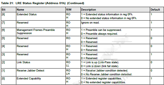

Hi Experts:
        i use the bcm89811 net phy, i read the phy register by mdio, It's on the link up, but the CPSW_SS_RGMII5_STATUS_REG  show the link is down ,enble the CPSW_MDIO_CONTROL_RE‘s 30bit,it will enable theMDIO state machine.
        my questions is :
       1, how the MDIO state machine work?
       2,how the mac get the link status?Is mac automatically reading the 0x01 register data of phy to get the status?

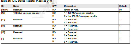

The meaning of bcm89811‘s register 0x01 is as follows。i use the psdk 7.0,I use my own board. The last version board used the phy of dp83867, which works normally. The hardware version of this one is only changed to a PHY, and there are no other changes.
Thanks.
  • Hi
    The right method would be to enable auto-negotiation if the PHY support and look at the status reported by MDIO module.,
    The MDIO module will continuously read link status as reported by the PHY and reflect the Link status correctly
    Are you saying that the MDIO status reported shows Link up for the PHY, but the RGMII status register reports link down.
    Can you dump the status reported by MDIO and RGMII for comparison
