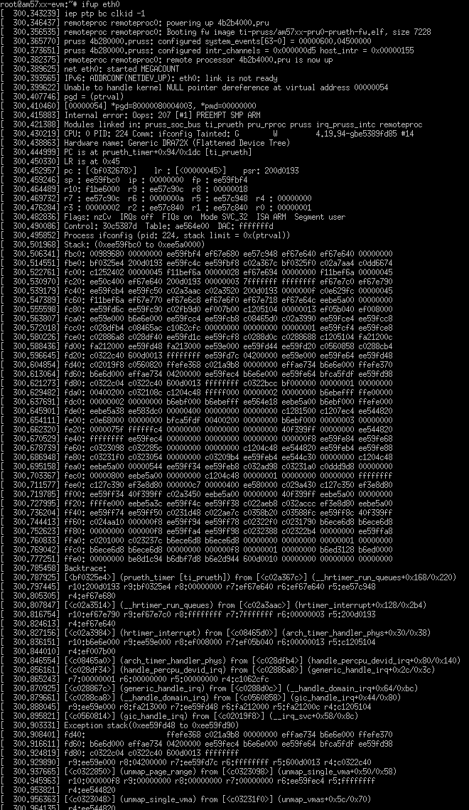

To the ifconfig -a command:
writes that eth0 is defined:
Issue of the command: ifup eth0 produces the following:
What am I doing wrong? Please, help!
