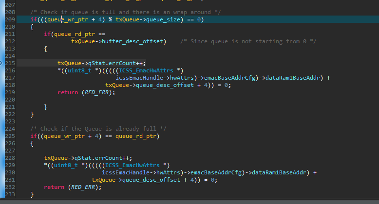

I observe issue related to PRU stop sending TX packets ("TX queue full" inside RedTxPacketEnqueue function) if CPU get bussy. Regardless of the new version (01.00.05.01), I also have a similar problem with version (01.00.02.00) on which my app currently running. If I check disassembly of PRU, it looks like it checking something and it looping in code, soo program doesn't halt or stuck. It also seems like it sending me an RX msg, but it doesn't TX. Can you please explain to me what conditions PRU check in case of TX? Queue is full .. why it doesn't send it out?
This app runs on custom board, so we are afraid that we have HW issue with DP83822 or we have some memory corruption on L3 or PRU ram.
Any suggestions where and what to check?

    We need some more details from you for further debug:
    1. What is the exact error code you see in "RedTxPacketEnqueue" function? Can you share the return value of the function?
    2. Do you see TX working for some packets initially?

    You ask me for the location and return of function when TX buffer is full and TX not working:
    Function return RED_ERR.
    Do you have any idea what can be the reason for this case? Can you briefly explain what are the conditions for TX operations on PRU?

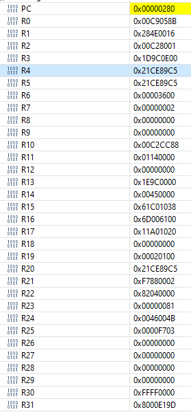

  • Hi Dhaval,
    maybe is totally irelevant info, but "to try is not a sin" :)
    PRU_ICSS1_PRU0 make in dissemble code some long jumps and loops.
    PRU_ICSS1_PRU1 loop from addrss 0x000280 to 0x000284.... seems like "while()"... is that true? Is this observation goes or point anywhere?
    Regards, Mare

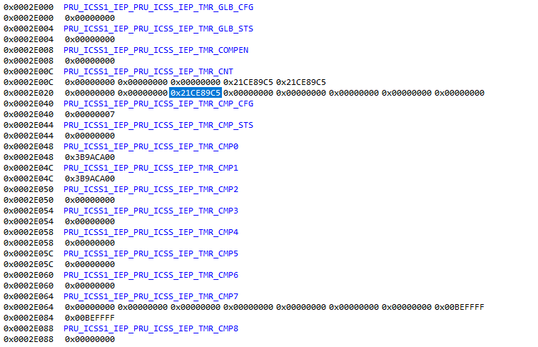

  • Hi Dhaval,
    It seems that location belongs to IEP timer.
    This is loop:
    C26 point to IEP:
    I'm not familiar with that timer, but it seems disabled?
    Any idea?
    register R5 is some location from shared ram (probably PTP related value) which seems the same.
    Sir, I really need some feed back or idea...
    Regards, Mare
