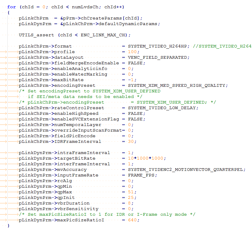

HI,
SDK: PROCESSOR_SDK_VISION_03_05_00_00
A15 run linux.
Camera 30fps, a frame 33ms.
The encoding is more than 33ms.
How to reduce the encoding time without reducing the definition of video recording

HI,
A15 run linux.
log:
h264 configure:
Please refer to the following datasheet for more information
The IVA-HD codec can support 1080p@60 FPS real time decoding & 1080p@30 FPS real time encoding.
Encoding can support > 30 FPS but it depends on the parameter configuration. Do some calculation to find out the FPS for other resolution
There is a bug in the vision SDK encoder link, the IDRFrameInterval is not updated in the encoder link. Add the below changes & try again
diff --git a/links_fw/src/rtos/links_ipu/iva/iva_enc/encLink_common.c b/links_fw/src/rtos/links_ipu/iva/iva_enc/encLink_common.c
index 2f9951c1f..3fef72138 100755
--- a/links_fw/src/rtos/links_ipu/iva/iva_enc/encLink_common.c
+++ b/links_fw/src/rtos/links_ipu/iva/iva_enc/encLink_common.c
@@ -831,6 +831,8 @@ static Int32 enclink_codec_set_ch_alg_create_params(EncLink_Obj * pObj,
pChAlgCreatePrm->numTemporalLayer = pChCreatePrm->numTemporalLayer;
pChAlgCreatePrm->enableSVCExtensionFlag = pChCreatePrm->enableSVCExtensionFlag;
pChAlgCreatePrm->enableWaterMarking = pChCreatePrm->enableWaterMarking;
+ pChAlgCreatePrm->IDRFrameInterval = pChCreatePrm->IDRFrameInterval;
return ENC_LINK_S_SUCCESS;
