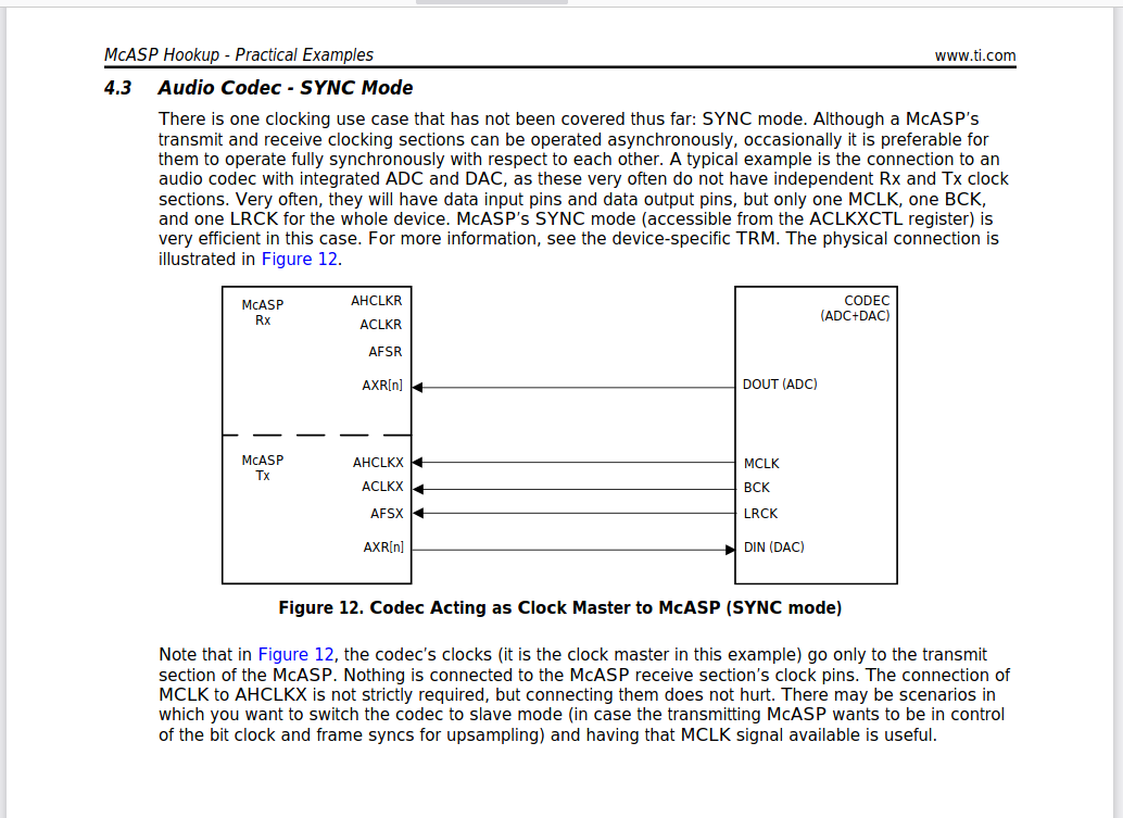

I am trying to connect audio codec with integrated ADC and DAC to AM3358. I am following MCASP design guide:
It mentions to enable MCASP's SYNC mode by accessing ACLKXCTL register.

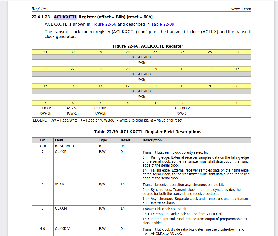

Here is how this register looks like:
I found the register in kernel/sound/soc/ti/davinci-mcasp.h file. In this file ACLKXCTL register has a default value of 0xb0 which is 10110000.
Is this already in SYNC mode? If not, then how do I change the value to make it go into SYNC mode?
