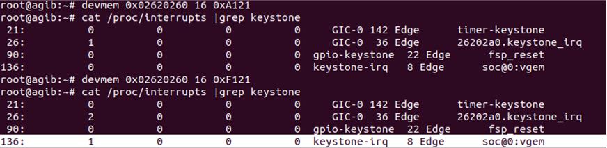

Whenever I set bit 0 of  ipcgr8 then, I see that kirq0 interrupt controller increase its counter.

  • Hello Sekhar,
    I want my kernel module to get notified when a DSP writes to ipcgr8  register, that at address 0x02620260. I thought by using platform_get_irq(pdev, 0) then, I could register a callback handler for the received irq and execute my driver activities.
    Yes I have the kirq0 in place, its working OK and  I see that when I set on bit 0 at  0x02620260 then, kirq0 interrupt increase its counter by one.
    Following 8 DSP configuration in dts then I added my module to kirq0 as such
    my_device {
    			compatible = "linux, my_driver";
    			interrupt-parent = <&kirq0>;
    			interrupts = <8 4>;
    			interrupt-names = "ipcgr8";
    and my kernel driver has been granted irq no 136. When I set on bit 0 at  0x02620260 then my driver's  irq handler is not called unless I also set on bits [15:12] on ipcgr8 register.
  • Hi
    kirq0: keystone_irq@2a0 {
              compatible = "ti,keystone-irq";
    The kirq0 working as IRQ de-multiplexer and it considers every bit in IPCAR8 as separate IRQ source (28 total). So,  for kirq0 IRQ 8 to work (and handler to trigger) the corresponding bit in ipcgr8 need to be set which fill reflect to IPCAR8.
    IPCGR8.bit12=1 + IPCGR8.bit0=1 --> IPCAR8.bit12 -> kirq0.irq8 -> handler.
    Note. Visible Linux IRQ number allocated and assigned dynamically.
