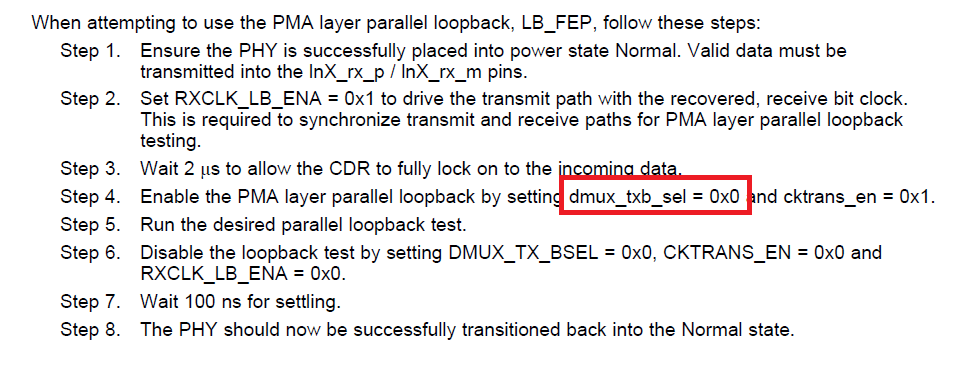

I have a question about the LB_FEP loopback mode introduced in the SPRUHO3a document.
Table 9-18 page 153 requires to set DMUX_TXB_SEL_O = 5 , while the explanations given in the text just below require DMUX_TXB_SEL_O_=0
Please could you tell which value is correct.
