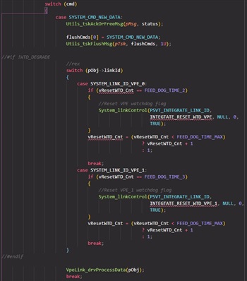

    in my test program, a part of  feed the watchdog is like this in vision_sdk\links_fw\src\rtos\links_ipu\vpe\vpeLink_tsk.c :
    It's just a simple System_linkControl() command, but it frequency is frequent and direction is complicated, may be from DSP to IPU, may be from EVE to IPU, may be from MPU to IPU, may be from IPU to IPU, anyways, I think the problem is the frequency, but I really need these watchdog.
    So I need to increase the numbers of mailbox ack queue or other solutions.
    Please help me to resolve the problem, thanks you.

    I know default tidlOD use-case is working fine, so what I emphasize is the watchdog of System_linkControl() I added.
    Or do you think the problem is not in the frequency of System_linkControl()?

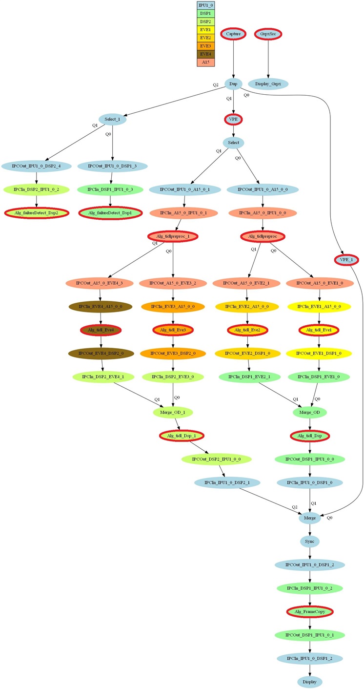

    The change is huge, but I can give you system architecture and somthing design thinking.
    In my usecase , I need 2 inputs of 1080p and 1 output of AHD 1080p, and the input must be processed by DL OD.
    The Alg_failureDetect_DspX is used to check some input camera failure, like the camera signal or illumination, I also need to resize the output, so I added the VPE_1, then I moved the object draw into the Alg_FrameCopy and added something algorithm.
    Finally, those with a red circle represent monitoring by watchdog, and the way of feeding the watchdog was mentioned in my previous reply.
    I think increasing the macro "UTILS_MBX_ACK_QUE_CNT_MAX" value from 4 to 8 is not the right solution, please wait I will discuss with the team & let you know.
