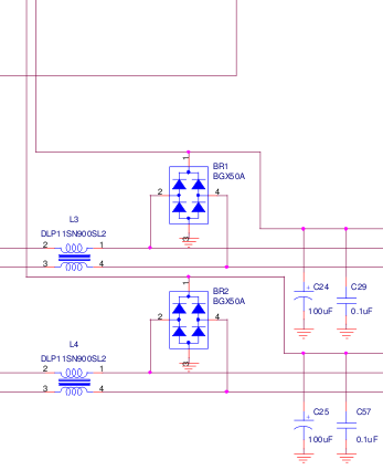

I am trying to bring up USB on DM365 custom board
In my custom board the GPIO 33 is connected to System self restart. So i disabled that and i connected The VBUS directly to 5 Volt (USB port ___5V.____USB_VBUS).
The ID pin is grounded through 0 ohm resistor. The DM and DP pins are connected to the processor through
And i made the changes in kernel

But if i Connected The pendrive or Mouse i am not getting any response
If i see /dev/sda. Nothing is there like this. I tried with 2.6.32-rc2 as well as 2.6.18. Both are giving Same response.

Where i am missing.
If i connected the USB directly to processor with wires then i am getting
usb 1-1: new full speed USB device using musb_hdrc and address 58
usb 1-1: device descriptor read/64, error -71
