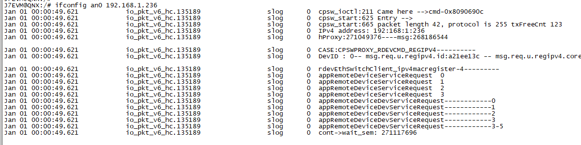

Debug PSDKQA package,starting CPSW9g with cmd:
on -C 0 io-pkt-v6-hc -d cpsw9g verbose=0x3ff.
I want to config static IP address for an0 using cmd : ifconfig an0 <IP addr>.
Error logs are as follows:
Error info is as follow
Any suggestion?
Thanks!

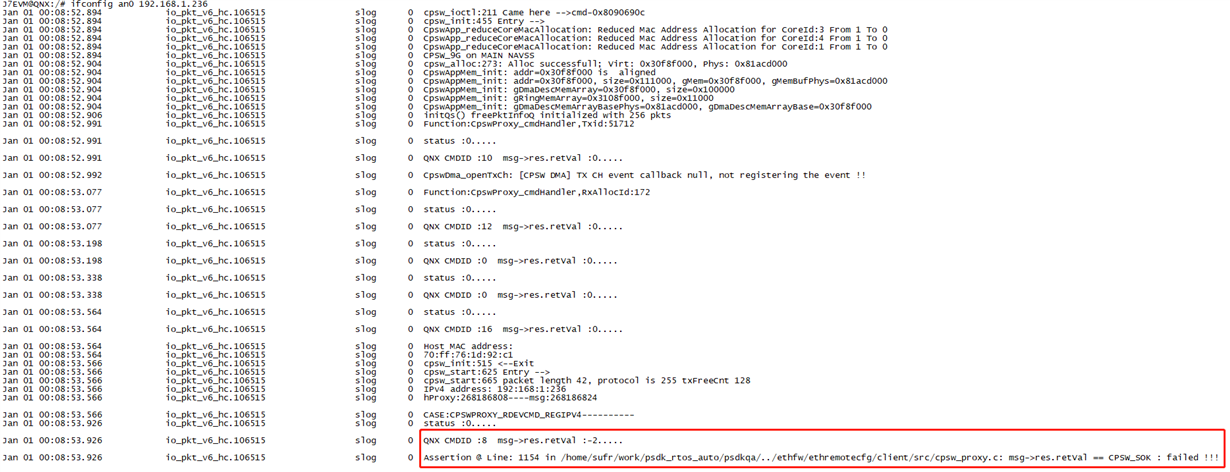

    Could you try the followings?
    # ifconfig an0 up
    # ifconfig an0 192.168.1.236
    Stanley
    I tried the cmds you suggested, it did not work.
    I compared the code between app_ethfw.c(vision_apps\utils\ethfw\src\) and main_tirtos(ethfw\apps\app_remoteswitchcfg_server\mcu_2_0\main_tirtos.c).
    There are some differences in EthFw init process.
    The function EthFw_initRemoteServices() is not called  in app_ethfw.c while called in main_tirtos.
    Is it the reason?
    Any suggestion?
    Thanks~
    Could you do the followings and share the full log starting from boot?
    # vision_apps_init.sh
    # slog2info -w &
    # on -C 0 io-pkt-v6-hc -d cpsw9g verbose=0x3ff
    # ifconfig an0 up
    I assume you were booting mcu2_0 image built from vision_apps. Please let me know if this is not the case.
    Stanley

    J7EVM@QNX:/# ifconfig an0 192.168.1.236
    Jan 01 00:06:07.284 io_pkt_v6_hc.143381 slog 0 cpsw_ioctl:211 Came here -->cmd-0x8090690c
    Jan 01 00:06:07.284 io_pkt_v6_hc.143381 slog 0 cpsw_start:625 Entry -->
    Jan 01 00:06:07.284 io_pkt_v6_hc.143381 slog 0 cpsw_start:665 packet length 42, protocol is 255 txFreeCnt 123
    Jan 01 00:06:07.284 io_pkt_v6_hc.143381 slog 0 IPv4 address: 192:168:1:236
    Jan 01 00:06:07.284 io_pkt_v6_hc.143381 slog 0 hProxy:268186808----msg:268186824
    Jan 01 00:06:07.284 io_pkt_v6_hc.143381 slog 0 CASE:CPSWPROXY_RDEVCMD_REGIPV4----------
    After the last cmd,there is no reaction on input.
    I added some logs for debug,hoping that would not influence your judgement.
    I recently found that,the process is stucked in waiting for semaphore(remote_device\client-rtos\framework\src\app_remote_device.c).
    Here is the log:
    I think the core A72 in main domain can not pass the config info to the core R5F through remote service.
    Is there anything special for ip config cmd?
    Whether i shoud do something else before ip config?
