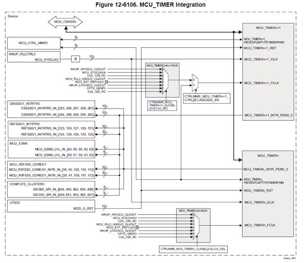

We are using QNX on TDA4V-mid. We implemented some safety related application which should align MCU_TIMER_2 with QNX system timer (in our case GTC is used as the system timer). One of the requirements says that both, system timer and MCU_TIMER_2, should have same clock source (to avoid clock drift problem). MCU_TIMER_2 is configured to use MCU_PLL2_HSDIV2_CLKOUT clock as input clock. Both, system clock and MCU_TIMER_2 clock, have 200MHz frequency. Now my question is, does MCU_PLL2_HSDIV2_CLKOUT and system clock, use the same clock source?

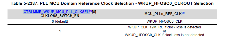

    Apologies for the delay in getting back to you.   The GTC and MCU_TIMER2 can have a common clock source which is WKUP_HFSC0_CLKOUT from WKUP_HFOSC0, which is likely how your system is setup.
    Details below on TI Processor SDK QNX default settings and also when MCU_TIMER2 is configured using MCU_PLL2_HSDIV2_CLKOUT as clock source.
    Should you seen any issues or this does not address the question please let us know.
    kb
    MCU_TIMER2 TI Processor SDK QNX Settings
    Reading from local target:

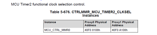

    MCU_Timer2 is sourced from WKUP_HFSC0_CLKOUT
    MCU_Timer2 using MCU_PLL2_HSDIV2_CLKOUT:
    MCU_PLL2_HSDIV2, likely sourced from WKUP_HFOSC0_CLKOUT.  Verify by reading 0x43008050.

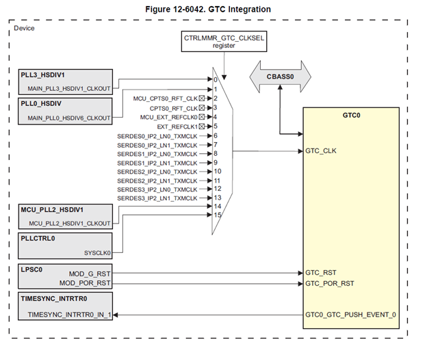

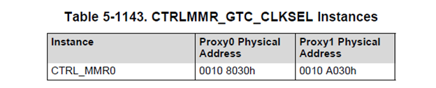

    GTC Processor SDK QNX Default Settings
    GTC using MAIN_PLL3_HSDIV1_CLKOUT
    GTC uses WKUP_HFS_OSC0_CLKOUT
