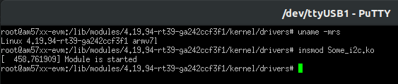

I use am5749(custom board) ti-processor-sdk-linux-rt-am57xx-evm-06.03.00.106. I would like to create some self made driver for i2c device(kernel module).

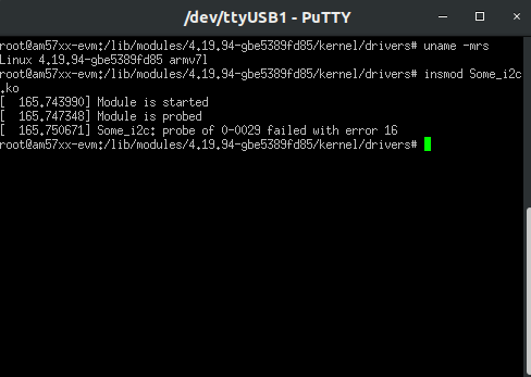

I know maybe it is topic not for this place but I can't find how to resolve this problem on another resources. I try to make self made driver because I have a couple of drivers which work with non rt linux and doesn't work with rt. I would like to understand how does it works and what is the problem.
The problem is: probe function is not called.
I add couple of printk for debug then compile it and try to do insmode after that I see : Module  some is loaded but I didn't see message from  probe.
What I do wrong?
I have example code:
