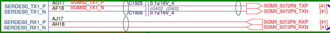

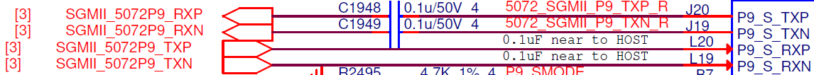

Hi TI members,
Our custom board has TDA4 connected to an external ethernet switch through SGMII.
We are using Linux + RTOS, and SGMII works fine in SDK 6.2.
I have tried some modification from this post and this post.
However, the SGMII link is never up in SDK 7.0.
Could pinmux be the problem?
Here is the value of SGMII status for port 1.
root@j7-evm:~# devmem2 0x0c000214
/dev/mem opened.
Memory mapped at address 0xffffa2390000.
Read at address  0x0C000214 (0xffffa2390214): 0x00000030
In SDK 6.2, the value is 0x00000031.

    About ethfw, we only use four pins for port 1 SGMII as below, which are the same as the EVM.
      - SERDES0_TX1_P (AG17)
      - SERDES0_TX1_N (AF18)
      - SERDES0_RX1_P (AJ17)
      - SERDES0_RX1_N (AH18)
    I also compared the pinmux tables of enabling eDP and HDMI, but the two pinmux tables are identical.
    So now I don't know what is the difference between eDP and HDMI that affects ethfw running.
    Eric Chen
  • Hi Eric,
    Sorry for the delay.
    I have notified the module owners
    Vineet
  • Hi Vineet,
    Thanks for helping out.
    I have been stuck at this problem for a while, but still cannot figure out why the link is not up.
    Eric Chen
  • Hi Eric,
    Which SGMII port you are using for MAC to MAC connection?
    Can you please share changes you made in EthFw etc. so I can review?
  • Hi Prasad,
    Thanks for your reply, it's nice to see you here.
    We use port 1, which used to be QSGMII main, of CPSW9G for SGMII MAC-to-MAC connection.
    We directly connect TDA4 to an ethernet switch, below is the partial schematics.
    Below are the modifications I made.
