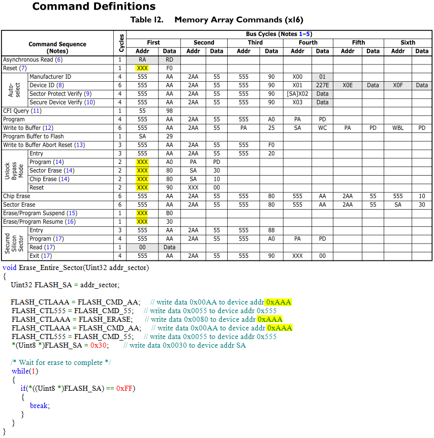

The manual of the NOR flash used on EVM6437 lists many XXXs as command addresses. In the real code for read, write and erase operation, I found that the XXXs are replaced by 0xAAA.
In general, X means “don’t care” in logic truth table, but it nevertheless must have a particular embodiment. So is 0xAAA the arbitrarily chosen embodiment for XXX, and anything else would also work in place of 0xAAA?
