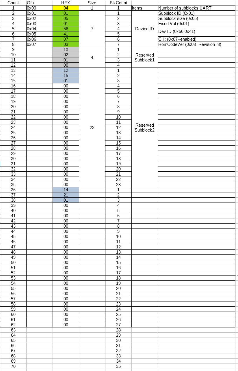

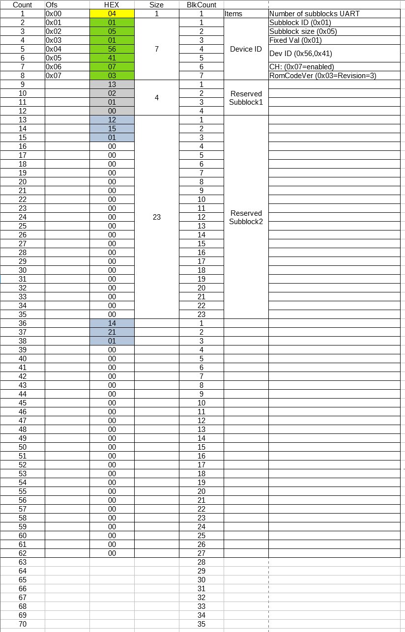

According to latest TDA2P_TRM (SPRUIF0C) Table 31-18 Struct ASIC_ID must be 70 bytes in UART case (1+7+4+23+35).
My TDA2P device answers only with 62 bytes ASIC_ID, but ROM code version is "3".
Please, see attached picture.
It's OK or not?
Device marking: "TDA2PHFUQACDQ1  8AP07KQ  941  ACD  G1"
AsicId Rom Version: 0x03

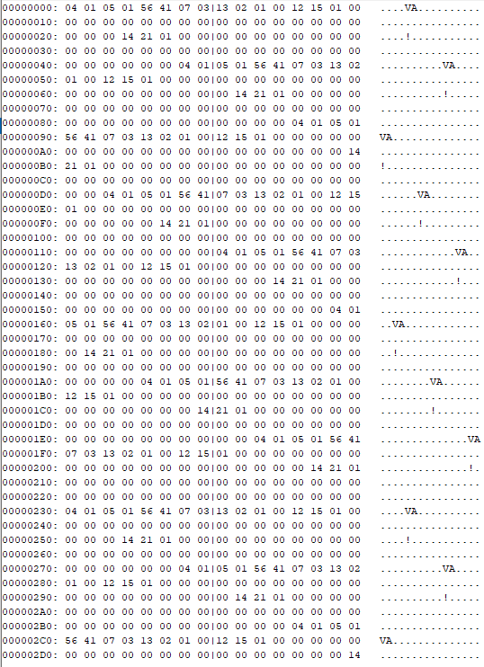

    I am checking on this with the ROM expert; I do expect the ASIC ID to start on the first byte.  What is your starting dump address?

  • Hi.
    Usb2Uart adapter was buggy. It was be replaced with new.
    Connection between TDA2P:Porz(in)/RstOut(out) and 917_A54:WarmReset(in)/RstOut(out=Porz) was be corrected.
    Now AsicID is always 70 bytes.
    See attached picture (dump from start).
    Yes, we can boot TDA2P device via UART.
    Problem resolved.
