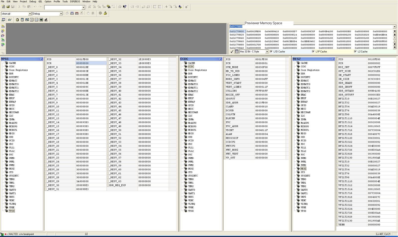

  • This is a screenshot of relevant registers after the timeout failure.  I had to open a memory window to the previewer registers, code composer did not have them in the register list.  I should note that the ccdc is enabled but not active during this time.
  • MattLipsey,
    PCR register settings of PREVIEWER indicate that PREVIEWER is configured in CONTINOUS mode, can you check that?
  • remember that the ONESHOT bit resets to 0 every time the enable bit is asserted.  It is set in the code.
