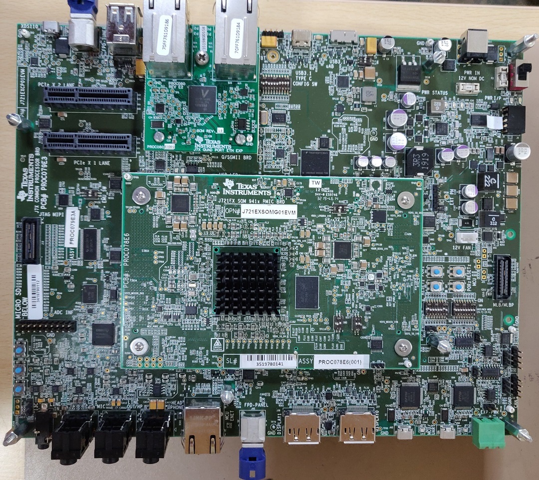

Because the EVM board we purchased does not have a Gesi sub card, I can't track the code conversion to my custom board.

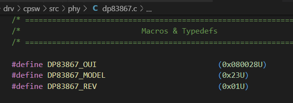

Therefore, I changed the code of dp83867. C and changed its oui, model and Rev.

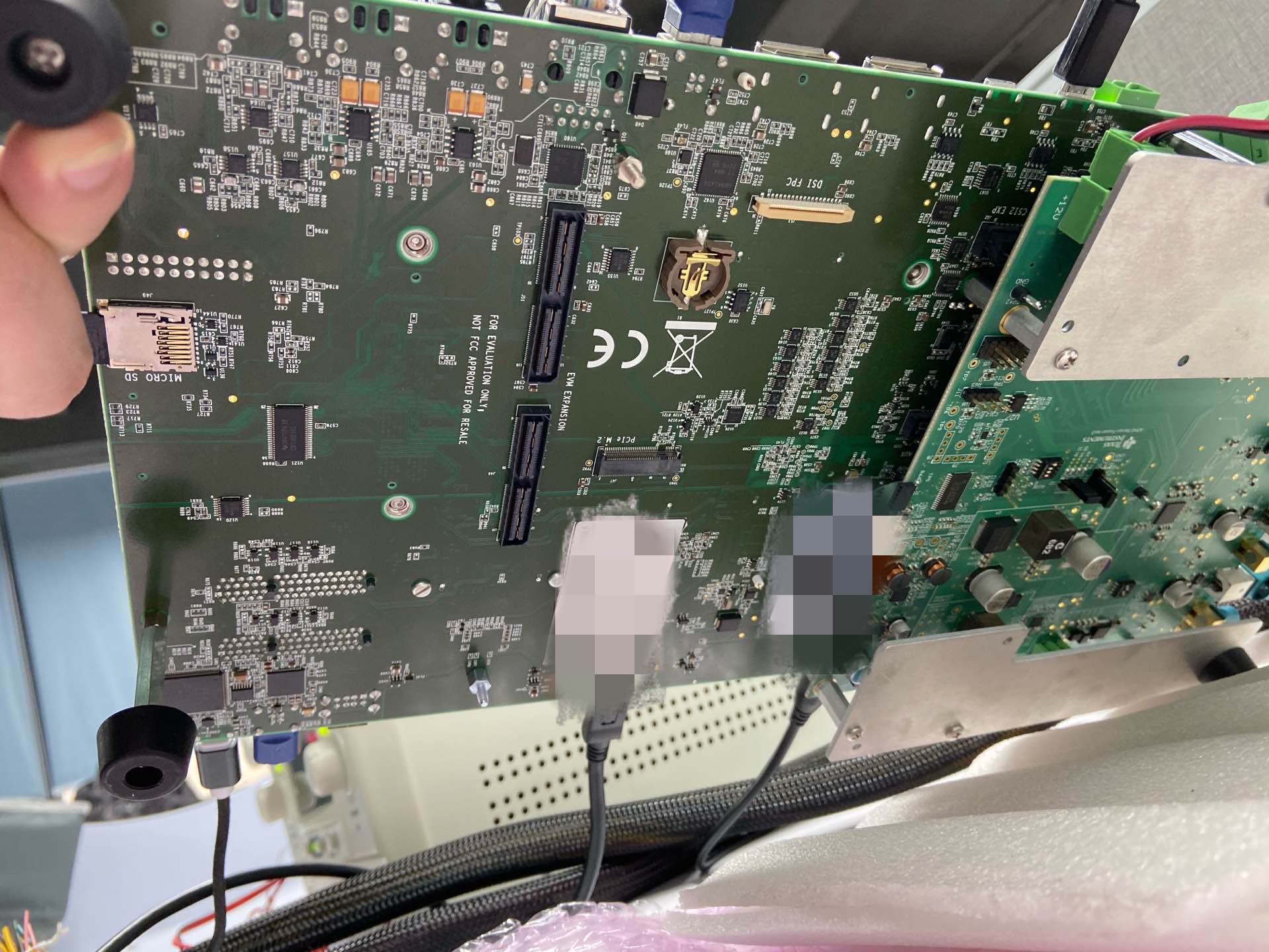

  • Because we designed our own boards,so we have to bring-up CPSW9G without the GESI cad.
    We connected 3 PHYs to 3, 4 and 6 of RGMII in tda4.
    Now we are using psdk-rtos v07.01.00 and we have changed the code.
    Now PHY can link up normally,:

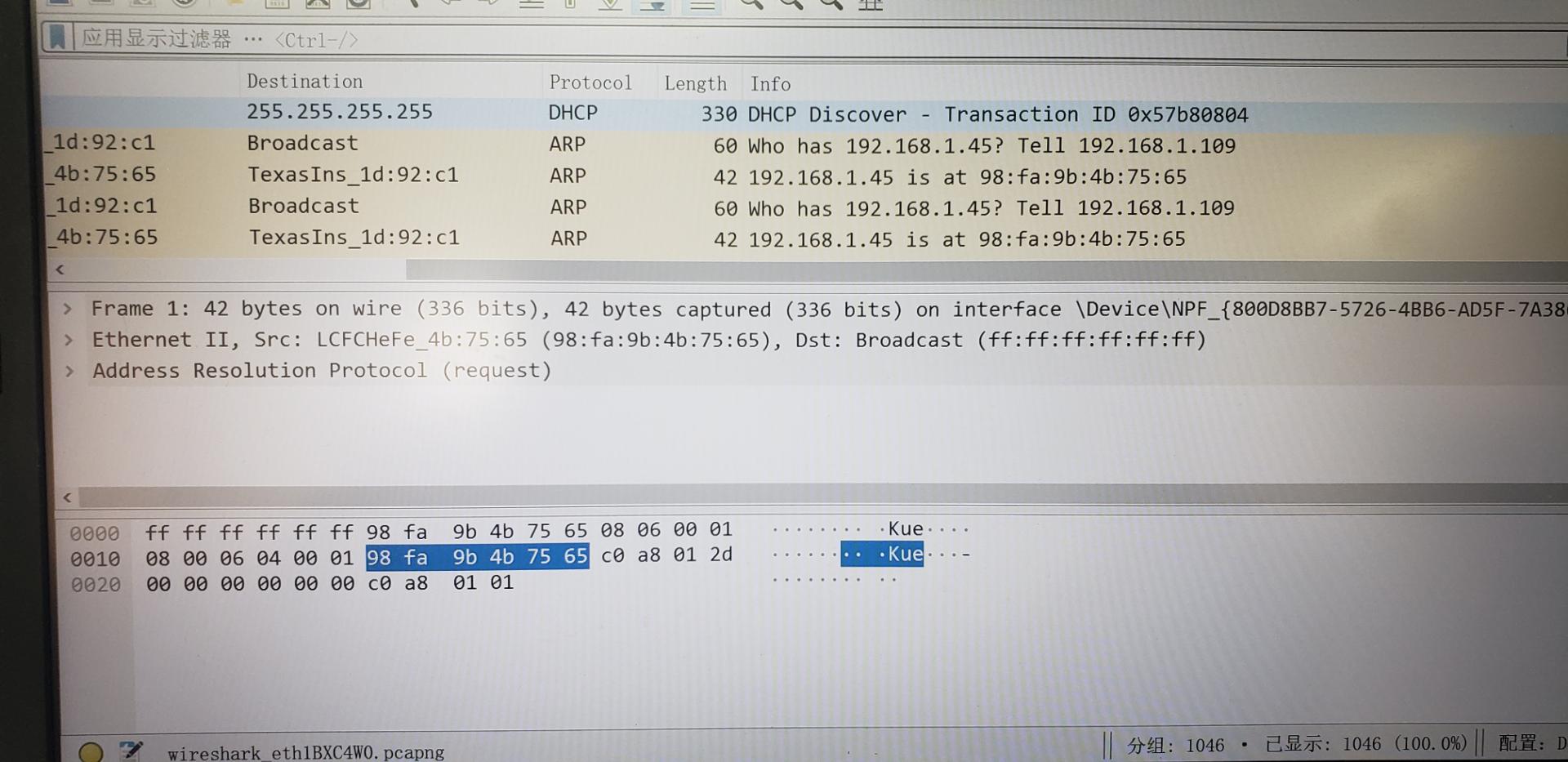

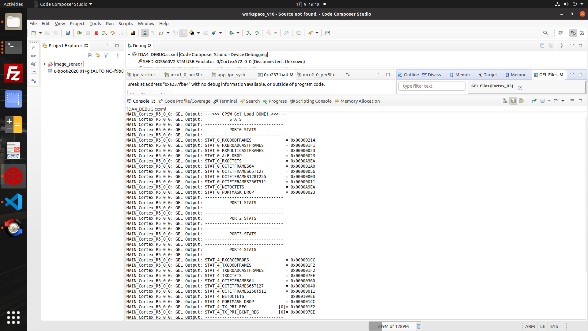

    14.574775 s: Cpsw_handleLinkUp: Port 5: Link up: 100-Mbps Full-Duplex
    but it seems that PING command cannot be used on A72 terminal.
    And sometimes, after inputting ifconfig command in the shell of the board, Linux will be directly stuck and can only restart the board. If don't get stuck, i can only see eth0 without eth1.

    Besides, I attached the CPSW 9G Stats below , hope it would be helpful for faster debugging.
    MAIN_Cortex_R5_0_0: GEL Output:           PORT0 STATS

  • Hi Hao,
    Statistics shows that packets are being transmitted. I don't see any RX statistics. Are you sending anything from PC?
    Also can you please connect wireshark and see packet transmitted from the TDA is seen.
    I believe there is a configuration issue in PHY which is causing packet being dropped in the PHY.

  • Hi Prasad,
    Now, we move step forward by changing some codes for supporting our customed board. currently, we ping PC from TDA4 board, and showing status by using wireshark:
    the result shows that PC can receive data packages and make response.
    Also. we probe on signal line, CLK、RXDV、RXD0 for RGMII are all right when PC send data packages to TDA4, but MAC can not receive any data from PC.
    And the Cpsw status is below,
    For mac port 4,  we doubt if the port mask and rx_crc would affect the recv function of cpsw; or what could we do to solve the cpsw recv failure.
    Rgs
  • This is goood! Packets are being transmitted and received by CPSW.
    The issue you are not able to receive packets in your application is due to CRC errors.
    Normally CRC errors happen due to timing when RGMII delays are not configured correctly. As per spec, there should be 2.5ns delay between clock and data lines.
    CPSW doesn't support configuring the RX (PHY TX) delay. You need to find out delay register in PHY data sheet and enable TX delay.
    Note CPSW TX delay is enabled (using RGMII_ID field in ENET1/2/_CTRL register so you dont need to change any config for TX (PHY RX) inside PHY.
