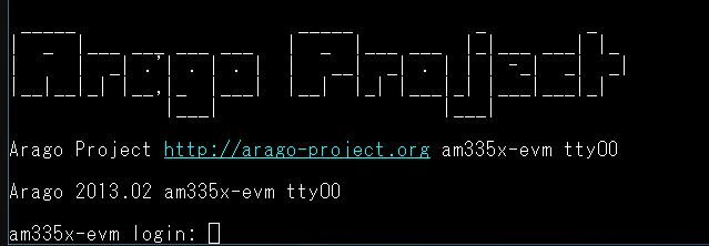

Hello Champs,
HW: AM3354 own board
SW:ti-processor-sdk-linux-am335x-evm-06.03.00.106
Customer is migrating ti sdk uboot,linux to his own board. Using SD boot mode, the serial port can show the SD data after booting up. But the display screen can't show correctly, it only showed "please wait..." like below snapshot.
He has tried other commands, but the screen can't display, either.
root@am335x-evm:~# /etc/init.d/matrix-gui-2.0 stop
Stopping Matrix GUI applicationstart-stop-daemon: warning: killing process 808: No such process
root@am335x-evm:~# /etc/init.d/weston stop
Stopping Weston
root@am335x-evm:~# /etc/init.d/weston start
Starting Weston
root@am335x-evm:~# /etc/init.d/matrix-gui-2.0 start
/home/root
Removing stale PID file /var/run/matrix-gui-2.0.pid.
Starting Matrix GUI application.
root@am335x-evm:~#

    Could you please share which PSDK they are migrating from and the Kernel boot log in a text file? Also, please confirm if the customer has configured the settings mentioned in the following page.
    Krunal
  • Hi Krunal,
    Thanks for your reply.
    Customer wanted to migrate ti-processor-sdk-linux-am335x-evm-06.03.00.106 to his own board.
    He has checked the configuration the page you mentioned. His LCD is  multiple of 32 bit, the page mentioned non  multiple of 32bit LCD.
    Below is the kernel log:

  • Hello Shin,
    Could you please share how the customer built the rootfs? Also, is the GPU enabled in the device tree file and how was the GPU driver compiled?
    Krunal
  • Hi Krunal,
    Customer used tisdk-rootfs-image-am335x-evm.tar.gz in SDK. Besides, if he used the arago-base-tisdk-image-am335x-evm filesystem, the output is below.
    Thanks.
    Rgds
    Shine
  • Hello Shin,
    Based on the above picture, the customer is using newer Kernel but an older filesystem. Please ask the customer to use the filesystem that comes with the PSDK6.3. (Ref. Link: https://software-dl.ti.com/processor-sdk-linux/esd/AM335X/latest/index_FDS.html)
    Krunal
