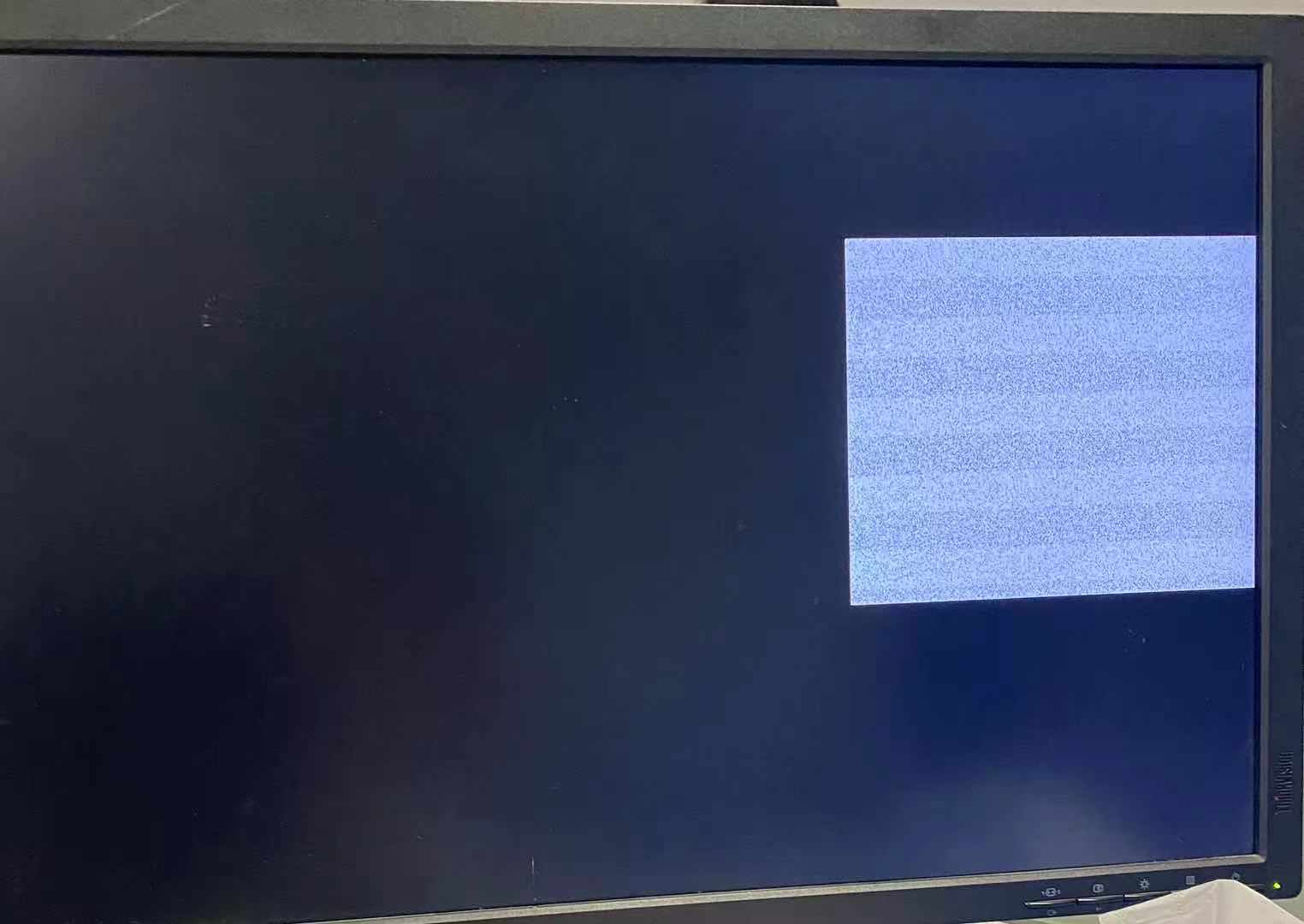

HI TI Members,
i tried to add a display node to my demo which turns bmp image to greyscale , to diaplay the input- and outputimage.
The Demo runs successfully with single display node for input image. But the Error appears in command status in function verifygraph in  function create_graph when I add the display node for output image in yuv420 format.
the log file shows as below.
Could you give me some tips?
Best Regards
Yuchen

    U8, as such, is supported in the display Node, so it should work. I am not able to see the exact error, could you please share the complete output log? I want to see if there is any error returned from the display node.
    Brijesh

  • Thanks Brijesh, i have uploaded the complete log file.
  • Hi Li,
    -10 error number is for invalid parameter.
    In the display create function, i see this error error is returned only two cases,
    1, display param struct is corrupted due to some reason.
    2, display pipe id is not correct.
    In your code, you are calling API app_create_graph_display2 to initialize display parameters, can you check if this API is initializing pipe id correctly?
    Brijesh
  • Hi Brijesh,
    i set PipeId=0 for Display1(output image) and PipeId=2 for Display2(input image).
    Pipeline Depth is set to 3u . should I call the function vxSetGraphScheduleConfig in this case?
    Below is my code for Display module.
    By the way what is -1 Error ?

  • Hallo Brijesh,
    now i just use the displayObj for the output image.
    If i set PipeId=0 and Pipedepth=1, i can get an imput image on display , which is not my expected output image.
    Then i chande Pipedepth to 2, then i get the Error show as below:
