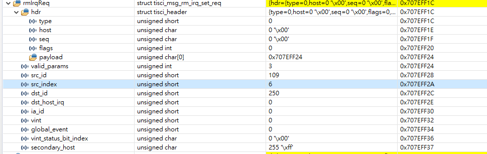

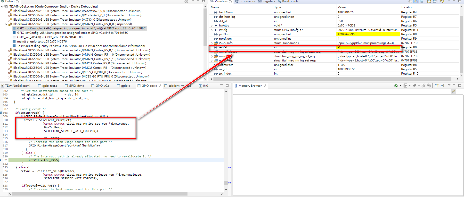

    I run CCS to debug GPIO_socConfigIntrPath(),
    Sciclient_rmIrqSet was return failed.
    Please see the following picture.
    So how can I solve this issue?
    KS
  • Hi Li,
    That's exactly why you are not getting interrupts.. GPIO is configured correctly, but not interrupt manager.
    Can you share the value of rmIrqReq.src_id, rmIrqReq.src_index, rmIrqReq.dst_id and rmIrqReq.dst_host_irq?
    Brijesh

    Here are the data of rmIrqReq.

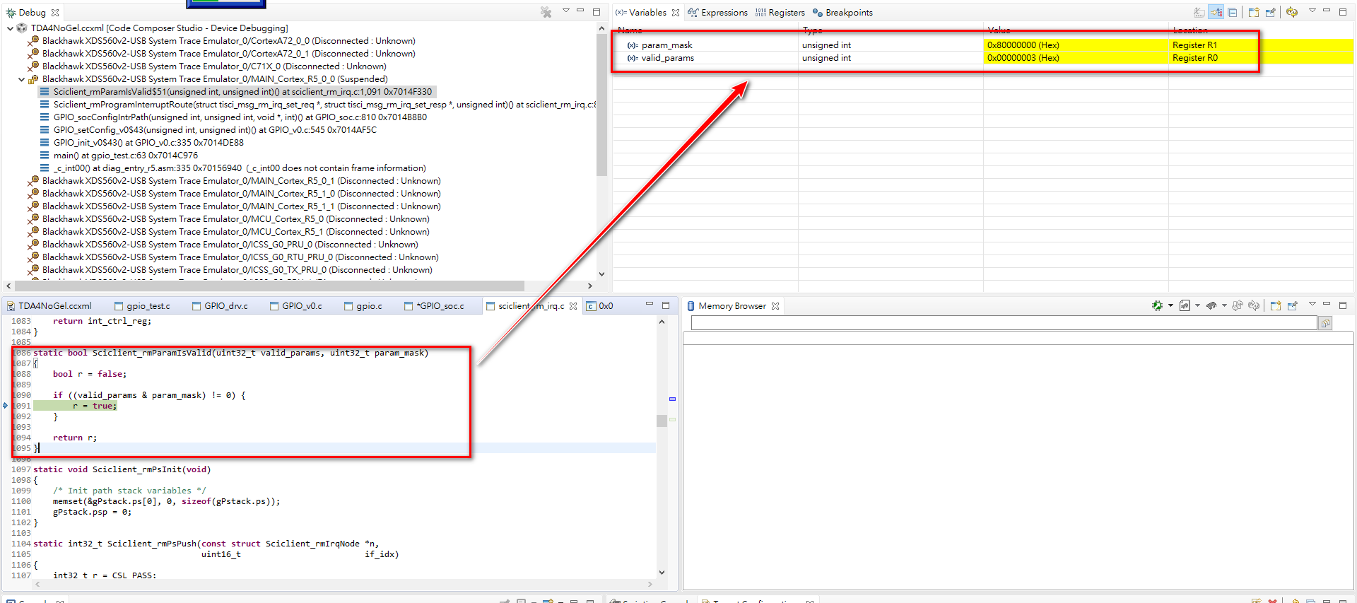

    I also traced to the return fail value is  from Sciclient_rmParamIsValid(). F.Y.R.
    KS.
    The parameters does seem to be correct still..
    Can you put breakpoint on GPIO_socConfigIntrPath API and just before calling Sciclient_rmIrqSet APi in the in the same function, can you change the rmIrqReq parameters to
    rmIrqReq.src_id = 109
    rmIrqReq.src_index = 6
    rmIrqReq.dst_id = 245
    rmIrqReq.dst_index = 24
    and just call Sciclient_rmIrqSet to see if it succeeds?
    Rgds,
    Brijesh

    [MCU2_0] 21.305550 s: [GPIO_socConfigIntrPath 811]rmIrqReq.src_id=109, rmIrqReq.src_index=6, rmIrqReq.dst_id=245, rmIrqReq.dst_host_irq=176
    [MCU2_0] 21.305831 s: [GPIO_socConfigIntrPath 839]retVal=-1
    [MCU2_0] 21.305895 s: [GPIO_socConfigIntrPath 779]src_id=109, src_index=6, dst_id=245, dst_host_irq=177
    [MCU2_0] 21.305969 s: [GPIO_socConfigIntrPath 811]rmIrqReq.src_id=109, rmIrqReq.src_index=6, rmIrqReq.dst_id=245, rmIrqReq.dst_host_irq=177
    [MCU2_0] 21.306196 s: [GPIO_socConfigIntrPath 839]retVal=-1
    [MCU2_0] 21.306295 s: [GPIO_socConfigIntrPath 779]src_id=109, src_index=6, dst_id=245, dst_host_irq=178
    [MCU2_0] 21.306375 s: [GPIO_socConfigIntrPath 811]rmIrqReq.src_id=109, rmIrqReq.src_index=6, rmIrqReq.dst_id=245, rmIrqReq.dst_host_irq=178
    [MCU2_0] 21.306613 s: [GPIO_socConfigIntrPath 839]retVal=-1
    [MCU2_0] 21.306673 s: [GPIO_socConfigIntrPath 779]src_id=109, src_index=6, dst_id=245, dst_host_irq=179
    [MCU2_0] 21.306746 s: [GPIO_socConfigIntrPath 811]rmIrqReq.src_id=109, rmIrqReq.src_index=6, rmIrqReq.dst_id=245, rmIrqReq.dst_host_irq=179
    [MCU2_0] 21.306972 s: [GPIO_socConfigIntrPath 839]retVal=-1
    [MCU2_0] 21.307030 s: [GPIO_socConfigIntrPath 779]src_id=109, src_index=6, dst_id=245, dst_host_irq=180
    [MCU2_0] 21.307106 s: [GPIO_socConfigIntrPath 811]rmIrqReq.src_id=109, rmIrqReq.src_index=6, rmIrqReq.dst_id=245, rmIrqReq.dst_host_irq=180
    [MCU2_0] 21.307364 s: [GPIO_socConfigIntrPath 839]retVal=-1
    [MCU2_0] 21.307429 s: [GPIO_socConfigIntrPath 779]src_id=109, src_index=6, dst_id=245, dst_host_irq=181
    [MCU2_0] 21.307505 s: [GPIO_socConfigIntrPath 811]rmIrqReq.src_id=109, rmIrqReq.src_index=6, rmIrqReq.dst_id=245, rmIrqReq.dst_host_irq=181
    [MCU2_0] 21.307734 s: [GPIO_socConfigIntrPath 839]retVal=-1
    [MCU2_0] 21.307789 s: [GPIO_socConfigIntrPath 779]src_id=109, src_index=6, dst_id=245, dst_host_irq=182
    [MCU2_0] 21.307863 s: [GPIO_socConfigIntrPath 811]rmIrqReq.src_id=109, rmIrqReq.src_index=6, rmIrqReq.dst_id=245, rmIrqReq.dst_host_irq=182
    [MCU2_0] 21.308083 s: [GPIO_socConfigIntrPath 839]retVal=-1
    [MCU2_0] 21.308140 s: [GPIO_socConfigIntrPath 779]src_id=109, src_index=6, dst_id=245, dst_host_irq=183
    [MCU2_0] 21.308213 s: [GPIO_socConfigIntrPath 811]rmIrqReq.src_id=109, rmIrqReq.src_index=6, rmIrqReq.dst_id=245, rmIrqReq.dst_host_irq=183
    [MCU2_0] 21.308474 s: [GPIO_socConfigIntrPath 839]retVal=-1
    [MCU2_0] 21.308532 s: [GPIO_socConfigIntrPath 779]src_id=109, src_index=6, dst_id=245, dst_host_irq=184
    [MCU2_0] 21.308609 s: [GPIO_socConfigIntrPath 811]rmIrqReq.src_id=109, rmIrqReq.src_index=6, rmIrqReq.dst_id=245, rmIrqReq.dst_host_irq=184
    [MCU2_0] 21.308899 s: [GPIO_socConfigIntrPath 839]retVal=0

    [MCU2_0] 21.594386 s: [GPIO_socConfigIntrPath 779]src_id=109, src_index=6, dst_id=245, dst_host_irq=185
    [MCU2_0] 21.594473 s: [GPIO_socConfigIntrPath 811]rmIrqReq.src_id=109, rmIrqReq.src_index=6, rmIrqReq.dst_id=245, rmIrqReq.dst_host_irq=185
    [MCU2_0] 21.594812 s: [GPIO_socConfigIntrPath 839]retVal=0
    [MCU2_0] 21.594874 s: [GPIO_socConfigIntrPath 779]src_id=109, src_index=6, dst_id=245, dst_host_irq=186
    [MCU2_0] 21.594947 s: [GPIO_socConfigIntrPath 811]rmIrqReq.src_id=109, rmIrqReq.src_index=6, rmIrqReq.dst_id=245, rmIrqReq.dst_host_irq=186
    [MCU2_0] 21.595008 s: [GPIO_socConfigIntrPath 839]retVal=0
    [MCU2_0] 21.595056 s: [GPIO_socConfigIntrPath 779]src_id=109, src_index=6, dst_id=245, dst_host_irq=187
    [MCU2_0] 21.595160 s: [GPIO_socConfigIntrPath 811]rmIrqReq.src_id=109, rmIrqReq.src_index=6, rmIrqReq.dst_id=245, rmIrqReq.dst_host_irq=187
    [MCU2_0] 21.595229 s: [GPIO_socConfigIntrPath 839]retVal=0
    [MCU2_0] 21.595281 s: [GPIO_socConfigIntrPath 779]src_id=109, src_index=6, dst_id=245, dst_host_irq=188
    [MCU2_0] 21.595353 s: [GPIO_socConfigIntrPath 811]rmIrqReq.src_id=109, rmIrqReq.src_index=6, rmIrqReq.dst_id=245, rmIrqReq.dst_host_irq=188
    [MCU2_0] 21.595413 s: [GPIO_socConfigIntrPath 839]retVal=0
    [MCU2_0] 21.595462 s: [GPIO_socConfigIntrPath 779]src_id=109, src_index=6, dst_id=245, dst_host_irq=189
    [MCU2_0] 21.595532 s: [GPIO_socConfigIntrPath 811]rmIrqReq.src_id=109, rmIrqReq.src_index=6, rmIrqReq.dst_id=245, rmIrqReq.dst_host_irq=189
    [MCU2_0] 21.595589 s: [GPIO_socConfigIntrPath 839]retVal=0
    [MCU2_0] 21.595637 s: [GPIO_socConfigIntrPath 779]src_id=109, src_index=6, dst_id=245, dst_host_irq=190
    [MCU2_0] 21.595706 s: [GPIO_socConfigIntrPath 811]rmIrqReq.src_id=109, rmIrqReq.src_index=6, rmIrqReq.dst_id=245, rmIrqReq.dst_host_irq=190
    [MCU2_0] 21.595764 s: [GPIO_socConfigIntrPath 839]retVal=0
    [MCU2_0] 21.595812 s: [GPIO_socConfigIntrPath 779]src_id=109, src_index=6, dst_id=245, dst_host_irq=191
    [MCU2_0] 21.595882 s: [GPIO_socConfigIntrPath 811]rmIrqReq.src_id=109, rmIrqReq.src_index=6, rmIrqReq.dst_id=245, rmIrqReq.dst_host_irq=191
    [MCU2_0] 21.595942 s: [GPIO_socConfigIntrPath 839]retVal=0
    [MCU2_0] 21.595989 s: [GPIO_socConfigIntrPath 779]src_id=109, src_index=6, dst_id=245, dst_host_irq=192
    [MCU2_0] 21.596057 s: [GPIO_socConfigIntrPath 811]rmIrqReq.src_id=109, rmIrqReq.src_index=6, rmIrqReq.dst_id=245, rmIrqReq.dst_host_irq=192
    [MCU2_0] 21.596138 s: [GPIO_socConfigIntrPath 839]retVal=0
    [MCU2_0] 21.596193 s: [GPIO_socConfigIntrPath 779]src_id=109, src_index=6, dst_id=245, dst_host_irq=193
    [MCU2_0] 21.596265 s: [GPIO_socConfigIntrPath 811]rmIrqReq.src_id=109, rmIrqReq.src_index=6, rmIrqReq.dst_id=245, rmIrqReq.dst_host_irq=193
    [MCU2_0] 21.596326 s: [GPIO_socConfigIntrPath 839]retVal=0

    In order to verify this issue simply and create a simple application loading from ccs, I refer the sample test application in pdk_jacinto_07_00_00/packages/ti/drv/gpio/test/led_blink.
    I found one difference for GPIO configuration - GPIO_configIntRouter().
    I add it to my test code.
    If GPIO_configIntRouter() called, the callback function will be triggered.
    Note: to add intCfg[pinNum].intNum = 178 + bankNum(=184) for MCU2_0
    I don't know why, please check it and provide correct usage of GPIO interrupt.
