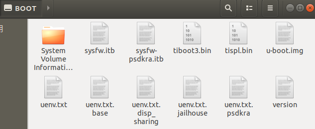

    Do you have any uenv.txt file on SD card? this will override any env settings you have stored.

    It boots from eMMC,and I flash eMMC using uniflash like this:
    1. sudo ./dslite.sh --mode processors -c /dev/ttyUSB1 -f /home/vmuser/psdk_rtos_auto_j7_07_00_00_11/bootfs/tiboot3.bin -d 4 -o 0
    2. sudo ./dslite.sh --mode processors -c /dev/ttyUSB1 -f /home/vmuser/psdk_rtos_auto_j7_07_00_00_11/bootfs/tispl.bin -d 4 -o 80000
    3. sudo ./dslite.sh --mode processors -c /dev/ttyUSB1 -f /home/vmuser/psdk_rtos_auto_j7_07_00_00_11/bootfs/u-boot.img -d 4 -o 280000
    4. sudo ./dslite.sh --mode processors -c /dev/ttyUSB1 -f /home/vmuser/psdk_rtos_auto_j7_07_00_00_11/bootfs/sysfw.itb -d 4 -o 6C0000
    Compared with the files in boot partition in SD card,it seems that more files should be haved flashed.Is it  the reason why the applications run incorrectly?

  • Hi HJ,
    You can ignore the uenv*.txt files, they are example environment settings for different use cases.
    The four important files are tiboot3.bin, sysfw.itb, tispl.bin and u-boot.img.
    If you are relying on any uenv.txt file settings, save them by default.

    As for the filesystem,it's copied from the SD card rootfs filesystem and it may rely on the uenv.txt file settings .To run the vision apps ,is there some steps to copy the uenv.txt files from SD boot partition?The uEnv.txt in boot partition is to select the .dtbo's which is required to run vision apps demos.

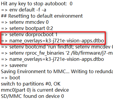

  • One way to workaround this is to set the settings from uenv.txt manaully once and do saveenv.

    I have saved it at uboot prompt.It doesn't work unless I configure environment variables at uboot prompt .Is there something wrong in environment variables?

  • The commands have some typo.. You are missing setenv command.
    => setenv <variable> <value>
    Ex:
    => setenv dorprocboot 1
    => setenv name_overlays k3-j721e-vision-apps.dtbo
    etc..
    Could you paste the contents of the uenv.txt you are using?
  • Hi Vishal ,
    Thanks for your reply! I use this uenv.txt.
    dorprocboot=1
    name_overlays=k3-j721e-vision-apps.dtbo
  • The uenv.txt you shared has only 2 settings. SO below two commands are doing the same thing.
    => saveenv
