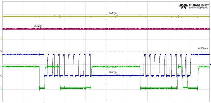

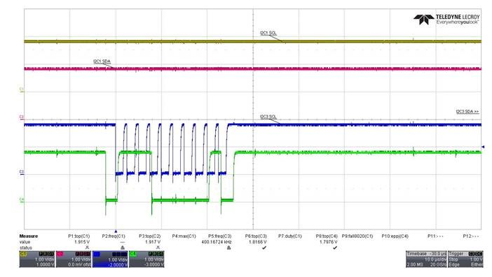

  • Hi Keerthy,
    We have a very strange behaviour:
    On working U-Boot 2018.1 we issue "i2c mw 0x70 1.0 1" and see the expected:
    If we do the same with U-Boot 2019.1 we see this:
    The slave, a PCA9546 I2C mux responds with a NACK (the second "1" signal).
    We have no idea why this happens on U-Boot 2019.1. We also do not see any jabber before this first transaction on this bus.
    Best regards, Chris
